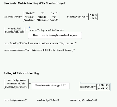

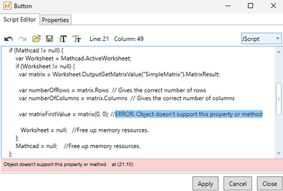

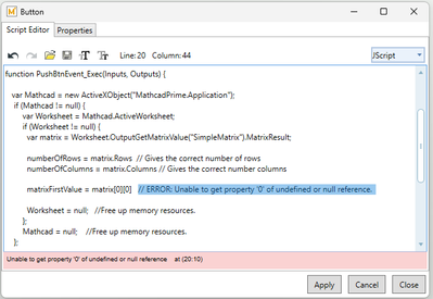

Does anybody know the correct code for reading out matrix content with JScript in MathCAD when loading it through the API?
This is the MathCAD simplified example in MathCAD Prime 11.
This is the code in the button:
Reading a matrix value like this works excellent when loading the Matrix as a normal input variable without API.
Other API functions works fine, like for instance Worksheet.Output.GetValue("EampleNumber").RealResult

Try matrixFirstValue = matrix(0, 0)
Cheers
Terry
Thank you for your proposal.
Unfortunately I get another error message: "Object doesn't support this property or method".
I tried both comma and dot as separator just to make sure.
I'm not sure that your variable matrix is a proper JScript array.  I think it might be a different kind of object.
Try result = matrix.GetMatrixElement(0, 0, mydata);  (result and mydata are arbitrary names)

Hi Stuart,
Thank you for looking into this. I have made an example worksheet, please see the attached MathCAD Prime 11 file.
In the worksheet there are two examples, one with standard input and one with API input.
With standard input it works fine but not when going through API, so there is something I don't get right with the syntax when working through API.
The code in the buttons are attached in case of problems with opening the mathCAD sheet. A screenshot of the sheet is shown below.

I'm sorry, André, but I can't see why your JScript code doesn't work.  I tried changing your code to make it more resemble the example C# output code example, but that didn't change anything (as I hoped it wouldn't!).
