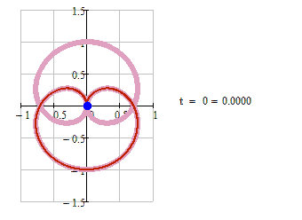

Hello Everyone.
From :
To :
  How to calculate Area of Parametric (closed) Curve, the above ? ( MathCad 15 )
  Thanks in advance.
  Regards.
  Loi

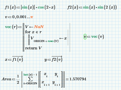

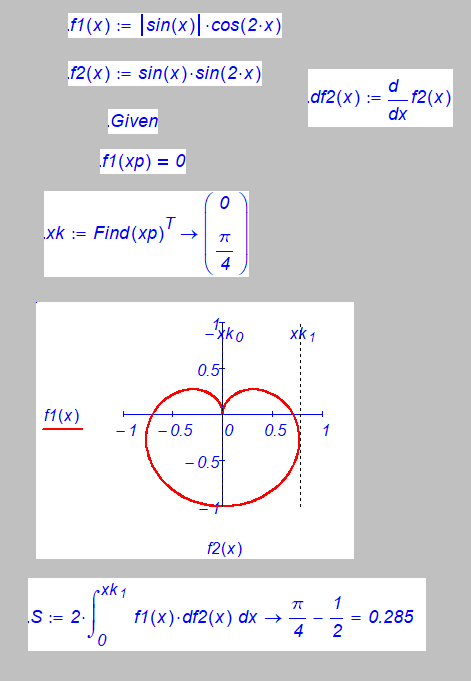

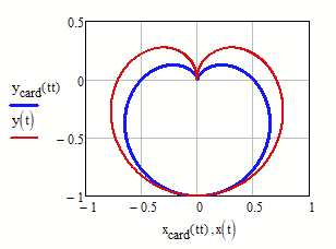

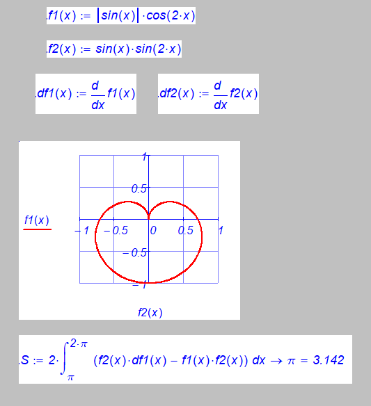

Your curve may look like a cardioide on first glance, but it isn't
Actually what you show is part of a larger curve with the parameter representation
and you get the curve you show for t running from 0 to pi
To calculate the area enclosed you can use Green's theorem  which possibly should be attributed to C.F.Gauß.
Using the parameter representation shown above and the limits 0 and pi for the parameter t, we get the enclosed area with

DJF
(To:lvl107)
While this problem is solvable with calculus - there are tricks to doing it other ways that can come in handy for other less mathematical shapes.  Shoelace formula (Surveyor's formula) works just using coordinate points.  Something Werner taught me years ago.

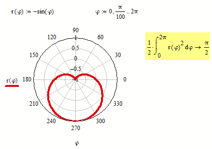

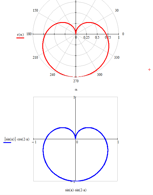

I thought that, as you usually do, you would look for an exact symbolic solution.
You can also represent your curve in polar coordinates, which makes calculating the area even easier:
lvl107
20-Turquoise

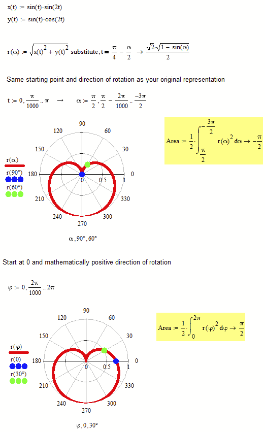

(To:Werner_E)

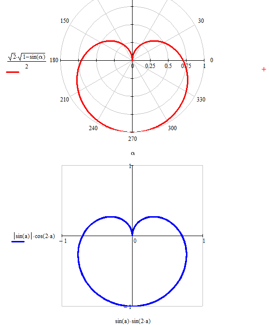

   Thanks for your suggestion, Werner. But I'm new to polar coordinates so I still confuse about the identical (coincided) shapes between red shape and blue shape :
   Thanks again.
   Regards.

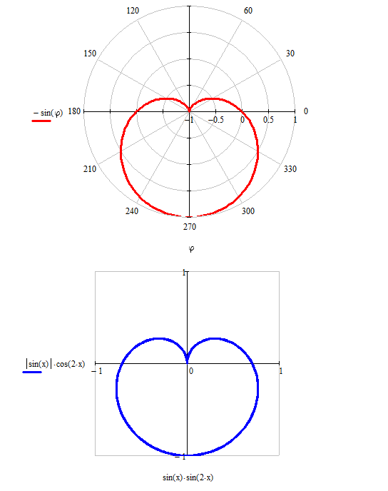

(To:lvl107)
Without negative radii it actually is that way
lvl107
20-Turquoise
(To:Werner_E)
Many, many thanks for your explanation, Werner. 😊 🙄 🤔. . . I got it. Now,they seems to be coincided ...
or :
  Now I have to say again : Tha...n...ks... , Werner.
