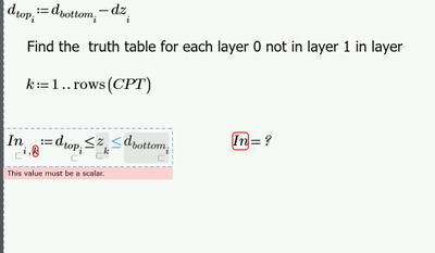

Hi Terry
I hope you are doing well . I know this very old question , I tried to use this function again  , but I don't know why I'm getting errors. Can you help me to fix it  > I couldn't upload the sheet          > BTW it works in the other sheet ok.

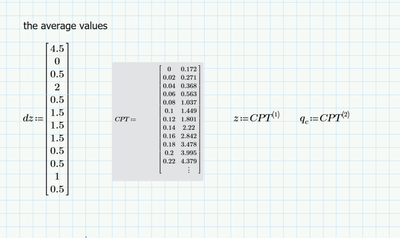

Okay I hope they solve the problem as soon as possible . Actually what I was trying to do is to find the average of qc in each layer ( it is a problem you helped me with previously) I wanted to compare your method to Terry's method . but I got that error ( ns is divided by zero which is true .

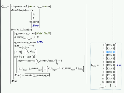

Can you help me to fix the program you wrote it  before for me : This is what you wrote from me

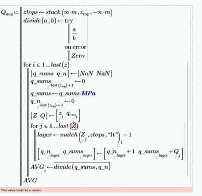

I made small changes : I changed ( Z) and q ... because an error appear ( that they should be vectors) and then change "It" to " near" .... However I got very strange values
It is strange because I am expecting only Qavg to be [12*1] not repeated as much as the number of z ... I hope you still remember this question when we first linked all the depths ( z) to the layer thickness (ztop) and then we found the average q in each layer .. it is the same , but now I try to do it only for one CPT and many .

I don't remember about this program but if the failing program you show in your first pic ever worked OK, then "z" and "q.cza" must have been nested vectors.
Not they seem to be normal vectors consisting of scalars and so the program fails. You cannot expect a program to still work OK if you change the type of data structure of the input variables.
When, in your second picture, you use "z" and "qcza" instead of the now useless "Z" and "Q", you are actually doing the very same calculation 12 times (assuming that z consists of 12 elements) and so you get a nested vector consisting of 12 equal vectors.
You may remove the outer for-loop (the one with "i") and see if the result is now what you expect.
