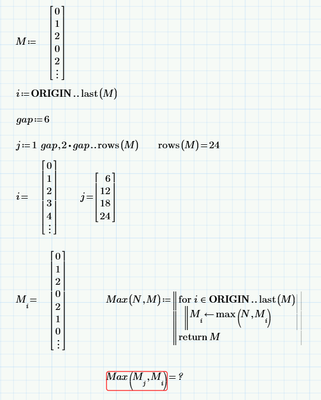

Dear All,
I am trying to assign the back to the largest value matrix within the gap =6 back to the range, i.e. 1 to 6, 6 to 12 and 12 to 18 and so on .. What is a suitable program and looping to do compare and reassign the largest value back to the range of matrix.

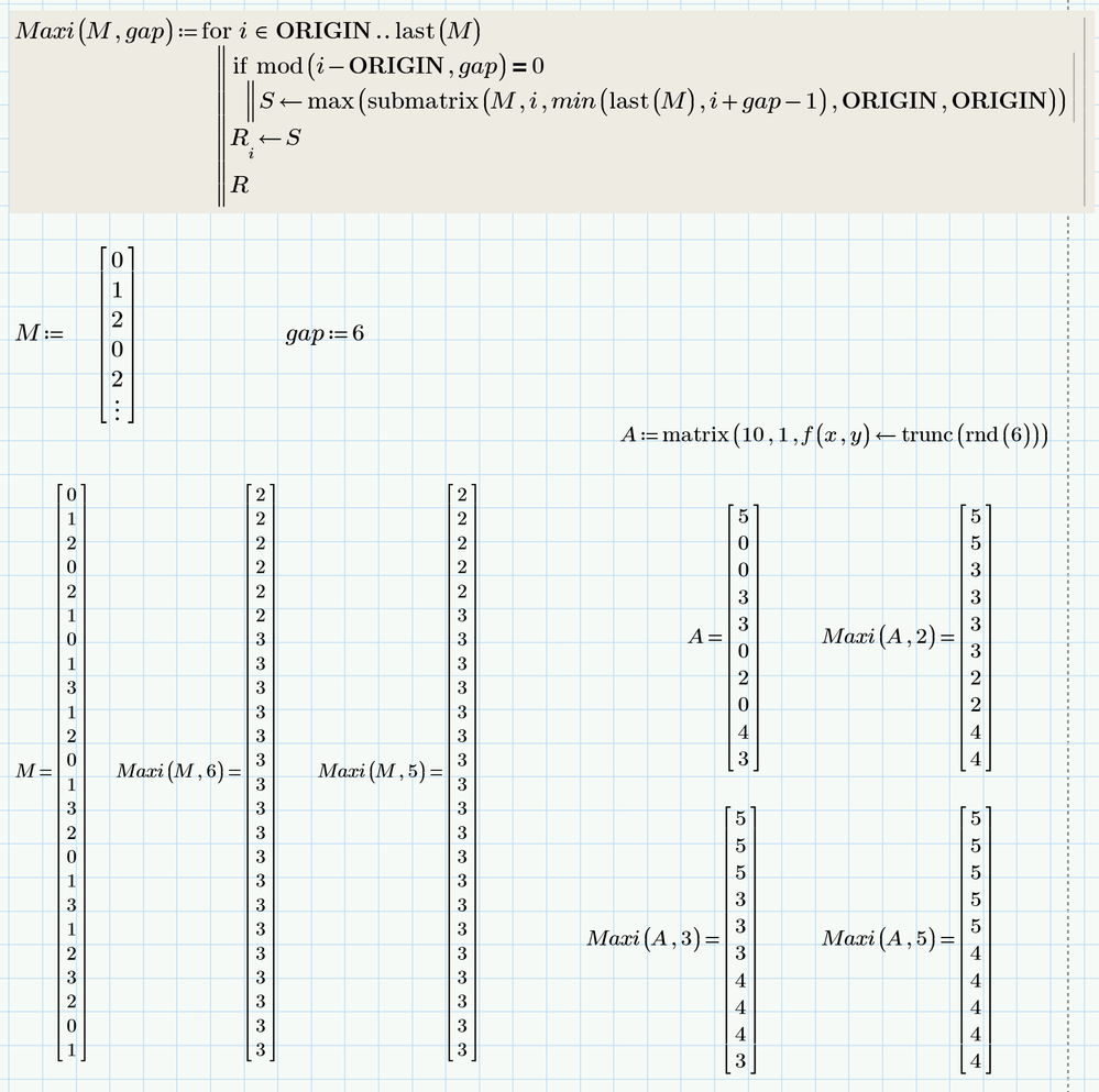

Unfortunately you did not provide a specific example of the vector you expect as a result and you did not answer the question what to do if the number of rows of M is not a multiple of gap!
As far as I understood you expect a result vector of the same length as M.
I also assumed that the last sub-matrix may be of a smaller size than gap if the rows in M are not a multiple of gap.
So here is my approach.
Attached file in Prime 9 format

Thanks Werner, this actually works....

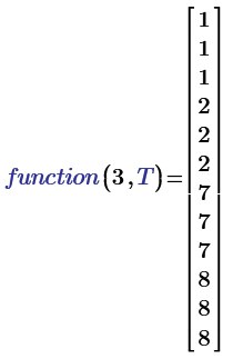

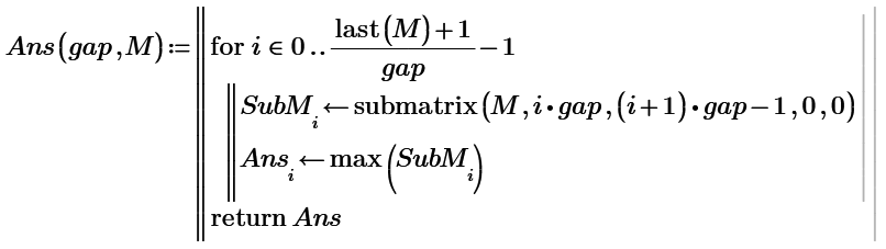

Assuming that your vector length is an integer number times the value of gap, this function could be what you're looking for:
With this example vector:
With various values of gap, results are:
Thank Luc, this solved the calculation I needed.
