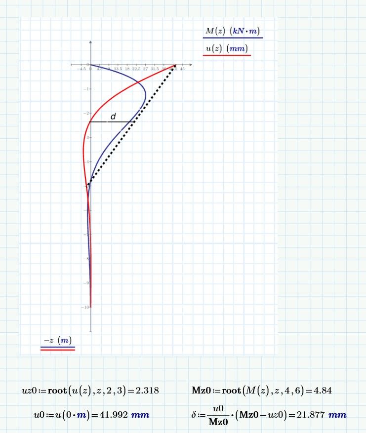

Hi
I want to calculate the maximum deflection of a structure subjected to bending. The deflection occurs within the buckling length, defined as the deflection within the points of inflection i.e. where M(z)=0.
I have plotted the moment and the deflection in the attached file, but need further assistance finding the maximum deflection within the buckling length (see page 2 in the attached file).
Any help appreciated!
Best answer by LucMeekes
Terry's file translated to Prime 7.
June 15, 2023
Like this?

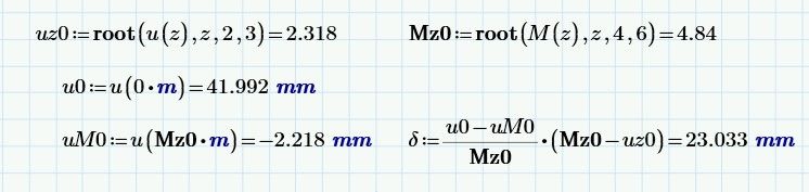

And if you include the small negative deflection at the lower point you get.
Cheers
Terry

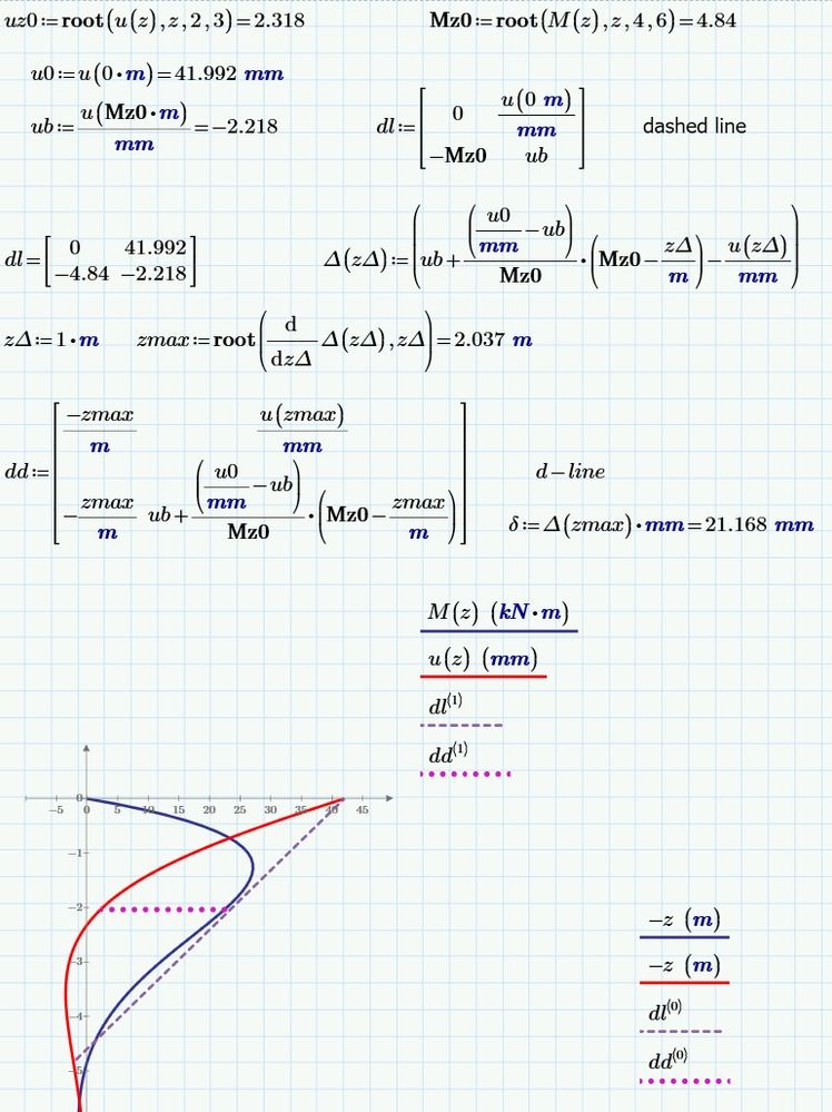

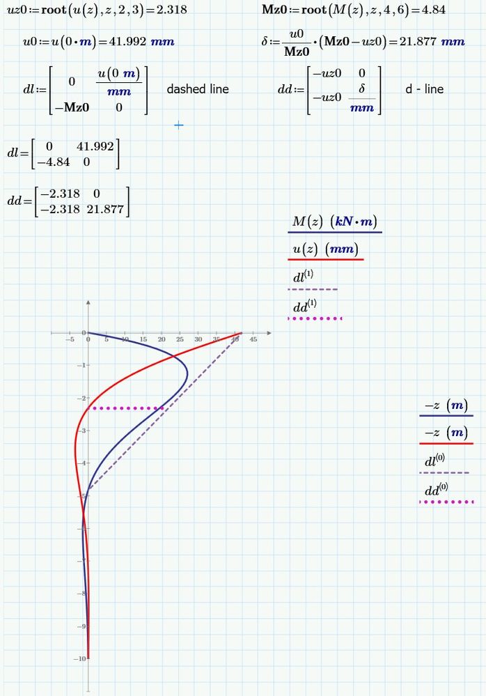

Thank you. What I'm really looking for is a function that automatically plots the dashed line and the "d-line" for any generic shape of the deflection curve.
June 15, 2023
Something like the attached?
Its based on Terrys solution.
You have a confusing mix at the abscissa - two quantities of completely different dimensions (units mm and kN*m).
So I decided for a dimensionless approach - after all Terry already made Mz0 and uz0 dimensionless instead of the appropriate units meter because he used root without units. So all I had to do was to get rid of the remaining units.
