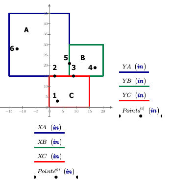

Hello @Werner_E and crew,
I've recently returned from a hiatus from the forum due to a busy schedule.
I'm back with a new project and seek your guidance.

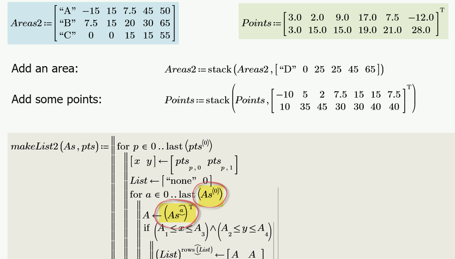

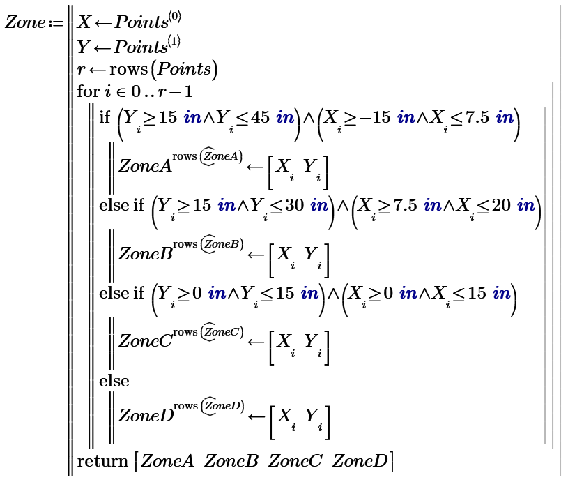

I'm presenting the following scenario: I'm dealing with three rectangles or zones: A, B, and C. Each zone has a priority level. I have a list of points that I need to plot and require the program to determine the zone in which each falls. Should a point land on the boundary shared by two or three rectangles, the program should assign it to the zone with the highest priority. I've been working with Mathcad Prime 9 and have devised a solution, but I feel it's lacking because I haven't effectively incorporated the priority level. Could you recommend a more refined approach? Below are snapshots for easier reference. In the real world scenario, there will be many more zones and huge list of points.

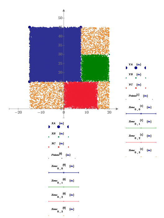

I added the ability to provide the data for the various areas in different ways as the nested matrix used in first place may not be the most optimal structure.
Of course it depends on the way the area data is available in your actual application. I don't think that you are supposed to manually type it all in and using a separate Prime table for each of the example areas seems not to be an appropriate approach for a larger number of areas anyway.
Instead of the areas being a vector of vectors, you may also provide them using a matrix - each row of it representing an area, defined by a name (has not to be just one character of course), the coordinates of the lower left and upper right corner and its priority.
There are only two changes in the makeList() function necessary to accommodate for this structure:

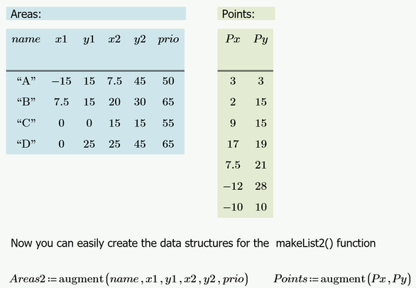

It would also be possible to provide the data using Prime's tables.
But I guess that tables are not really helpful when it comes to larger data sets. Anyway, here is an approach using tables for input:
Modified Prime 9 sheet attached

Your approach is missing the priority values!
I may be wrong, but as I understood incorporating them was the main reason of this question.
and I guess it would be a bit cumbersome and lengthy to adapt your approach to a greater variety of areas 😉

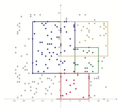

Changing B's x from 0 to 20 and C's y from 0 to 20, we get same result by the priority of if function. A>B>C>D...
Add star as first priority.

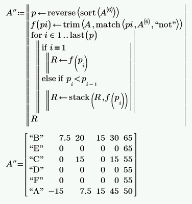

Does the input have to be the way it is now? As the areas are rectangles you only need xmin, xmax, ymin and ymax to define them. When you add to that two columns (label and priority), you have a matrix with the required input. Your new problem becomes sorting that by priority taking into account the original order in case of equal priority. After that choosing the area, where point belongs, becomes trivial - you just check the modified input row by row and the first hit is the area for that point.
You can naturally use the current input to form the new one as a second choice.
Sorting of the array could also be accomplished using "csort" and "reverse". But doing so would NOT preserve the order of the elements with equal value. So in your example "E" would be the first entry for priority 65 and not "B".
If thats not a problem (as I understood @Perez  had just demanded a consistent rule, the order of definition was just a suggestion/example) we could as well use
In the original sheet the 6 should be replaced by 5 because it uses ORIGIN=0.

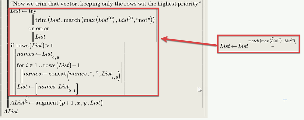

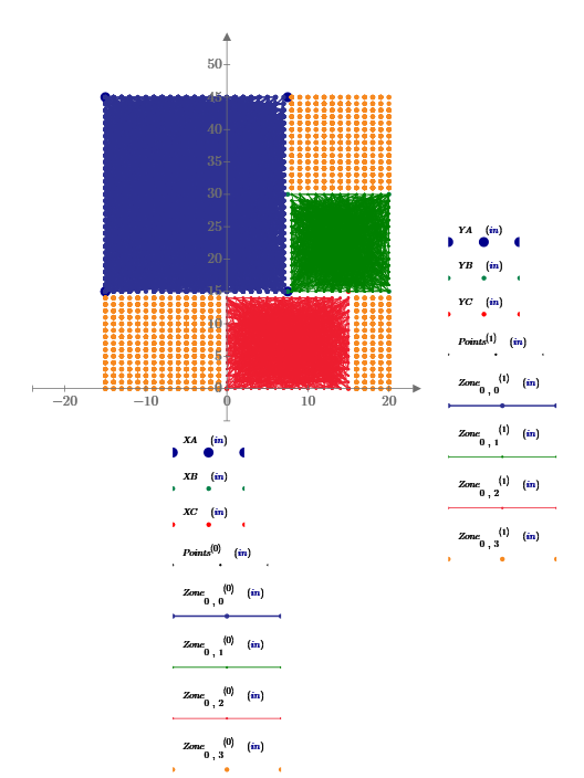

Hello @Werner_E , I'm reviewing your latest file WE_20240304(3)_PointLocator_V1.0 and running some tests but it seems the function makeList2() is working as expected so far. I should be able to accept as solution by the end of the week. Thank you for looking into this.
All the makeList() functions are doing the same and can be modified so that each point is assigned just one area only as described above.
The difference is just the way the areas data is provided. This essentially depends on the form in which you have this data at hand and how you import it into Prime. It is also conceivable to define the areas by the coordinates of one corner along with height and width.
However, my first chosen data structure with the nested vectors is probably rather unfavorable. The matrix, which was also suggested by JKT, is probably the most practical structure, I guess.
