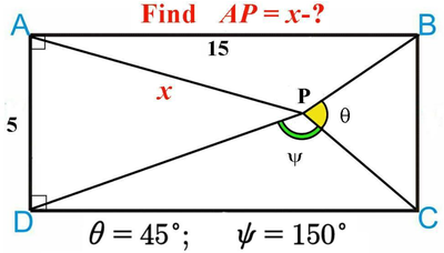

I've seen more math problems like this...
angles DAB and CDA are 90deg, so we know that AB and CD run in parallel, but the length of CD is not given, and neither is the length of CB. There's no telling if CB runs in parallel of AD.
I doubt if the problem can be solved with just knowing the sum of angles psi and theta. If not, I'm afraid the problem cannot be solved.

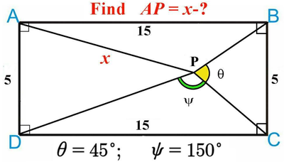

Sorry - more correct picture
(To:LucMeekes)
Hmmm, somewhat sophistic and quibbling, but definitely correct 😉
All we could say with the original specification is that x is in the range from 5 to 15.
In the meantime Valery has added (much too much 😉 additional specifications (one of the additional right angels or one of the additional lengths would suffice).
P.S.: Its a thread by Valery, so it definitely needed an animation 🙂
LucMeekes
(To:Werner_E)
Yes,  much too much. Simply stating that ABCD is a rectangle would have sufficed...

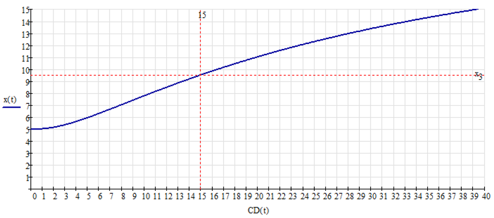

To Werner: Thanks for animation but better to have the x(CD) plot.

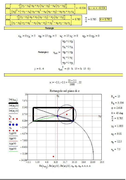

angles DAB and CDA are 90deg, so we know that AB and CD run in parallel, but the length of CD is not given...

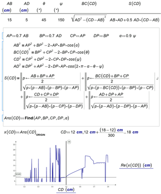

My try of numerical solution
I modified my animation file and got this:
Sorry!
May be this problem has not one but more solutions?

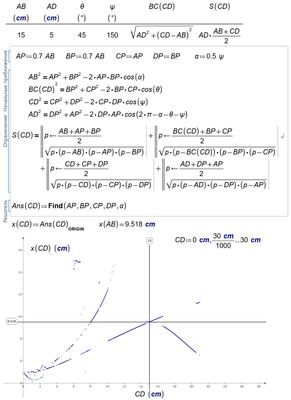

Mathcad 15 (the first method in Find):
You may add some constraints to get rid of the "multiple solutions" but the results are still unusable in a wide range.
The most important constraint is just that for alpha.
I added a function so you can see what it should look like and where your solve block still fails.
Guess you would need additional constraints to ensure that the point P is INSIDE the rectangle.
I also added another way to compare the areas (the one Francesco had used) - the results are a little bit better but it does not really helps that much.
I added a table at the end of the sheet so you see that your solve block fails sometimes, but most of the time it simply isn't able to come up with a solution at all. Maybe that can help you to improve your solve block.

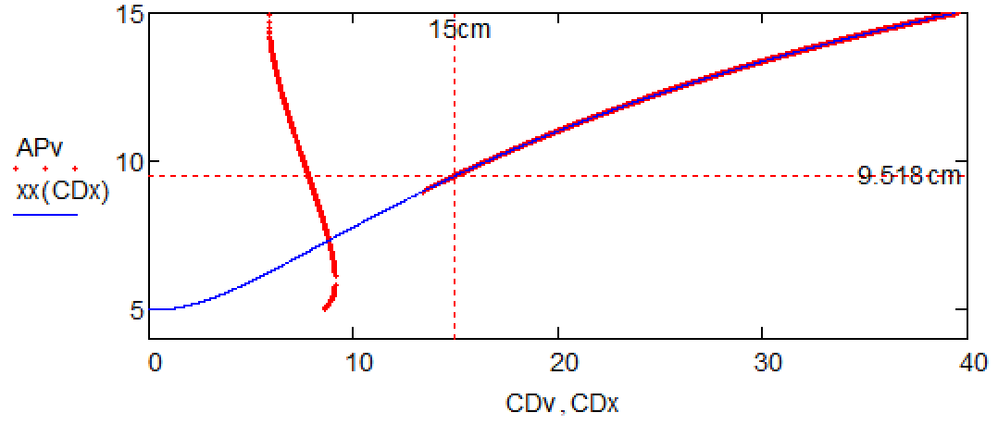

And what about this solution?
I don't see why you call it a "solution" - you sure see the discrepancy.
I also wonder what you are looking for, what the new goal of this thread should be.
From your post yesterday I thought you were interested to find out why your solve block fails or returns wrong values and how you could fix this. So I tried to provide you with the correct solution to compare with and some tools which might help in finding out whats going on.
Now you post a significantly different sheet which again returns wrong solutions. Why? What is it you want to find at the end?

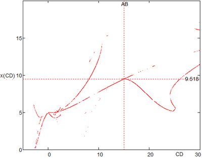

Update. All that remains is to do the animation:
I am tormented by doubts. It seems to me that in this zone there is either no solution or more than one solution!
The reason you get no or multiple results is because your solve block equations seem not to be well conditioned. Guess you need additional or other constraints to make the solve block work OK within the full valid range for CD. You sure know about this problem from your various experiments with different catenaries
As long as we demand that P has to be inside the quadrilateral there is exactly one solution (which is also shown by my animation).
You should try to calculate the coordinates of the point P from the solution lengths your methods give you and check, if the point is inside and if two initial angles (you have to calculate them with the coordinates of P) are still correct.
You should see that the second "solutions" you get are not really solutions as they violate either the rule that the point is inside or the angles are wrong.
It should be clear that, if CD changes, P is moving on a circle from D (for CD=0) to B (for CD approx. 39.434) as it has always to be seen at an angle of 165° from the segment BD. There is no solution for P inside the quadrilateral for CD > 39.434.
Create an animation using your calculation methods where CD changes from 0 up to 40 and show the quadrilateral, P and the calculated(!) angles psi and theta.
And .... if you really think that there may be no or two solution for, lets say, CD=9, then take a piece of paper, ruler pencil and compass and manually try to construct a solution. The two circles you have to intersect in doing so will intersect in C and P and I am pretty sure that there will be no third point of intersection and that P will be inside the quadrilateral - so you will end up with a unique solution.
