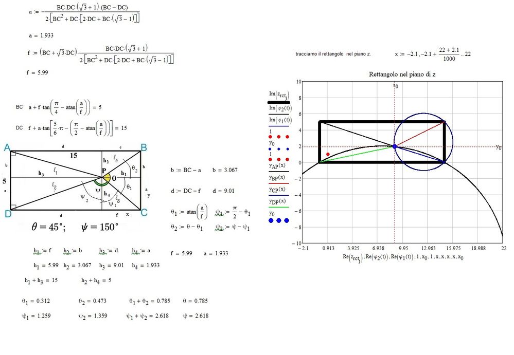

If you drop the constraint that P should be inside the rectangle (or quadrilateral in the extended problem version with variable length CD) a second solution is possible. Only constraints are now the two angles psi and theta (without orientation!). There is NO second solution in the range for CD which Valery had highlighted in his plot, but accepting points outside of the rectangle/quadrilateral there are two solutions for CD greater than approx 13.66 (exact: 15-5*cot(75°)). The range 0<CD<13.66 seems to be exactly the range where Valery's last attempt did not come up with any solution. In fact here the solution is unique.
See for example in the picture the second solution for the initial problem with the rectangle. While the solution point inside the rectangle had the approx. coordinates P(9,010 / 1,933) the solution outside has the coordinates P2(12,868 / -1,016).
The two solutions for x in this case are

If if do not demand that P should be inside the quadrilateral, then yes. But its not as you show in your picture. As I already wrote in my post above, there are only two solutions if C>13,7 (approx., exact expression is given in my post above). For 0<CD<13,7 there is only one single solution.

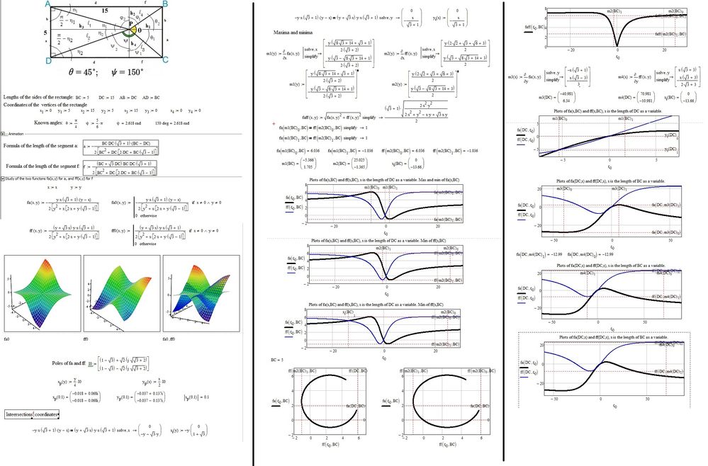

A different approach to the problem, but with the same previous results:
Study of the problem. Possibility of freedom of movement of point P (x0, y0).
I should say something about the possibility that the point P can move at least around the rectangle. From this analysis it seems possible. It requires further study.

It is the study of the trend of the two segments, a and f, varying the dimensions of the rectangle sides simultaneously (the two surfaces) and of one side at a time (graphs).

But no matter - anyway, to conclude for what ever it may be worth, here is a small animation made a few days ago, which shows the position of the possible solutions for P and the graphs of the distance functions at variable distance CD.
