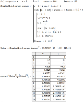

Hello, I want to change an existing Mathcad scheme of solving to another described in a flowchart.    I cannot.   I attached the Mathcad file where I try, and also the Flowchart that I want to implement.

Thank you very much. We are very closed on what I want to obtain.  And BREAK command how I implement ?:
Break, if f(x_i)=0
Also, in the new obtained form (attached) I cannot obtain the table of iterations i  vs  x_i.
Break, if f(x_i)=0
Go to View | Toolbars | Programming.  This will bring up a toolbar with "break" and "continue".  You must use the toolbars not type the words.

Hi
Code with:
View | Toolbars | Calculator and choose absolute.  NOT the one on Matrix toolbar.
View | Toolbars | Programming and choose break

Cool !  Now it is solved. Thank you very much, both of you !   I attached the updated file with the last feedbacks.

I optimized the file.   I also used   /\  (AND the logical)      in order to compact the algorithm.    ORIGIN I removed because Mathcad dont like it and marked it (i think because it is in the settings).
Now I am perfectly pleased with the results.
