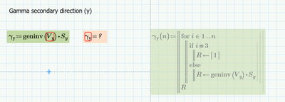

i just have a problem with this
is there a way to define gamma_y when the needed matrixes are not defined? I tried different thing with IF and else, but mathcad always evalutes the whole expression, and returns an error when something is not defined. is there a way around this? I know that when n=3, the matrix will be undefined, and would like to simply define gamma_y as a 1x1 matrix of value [1]
If you have a solution, I would be very happy! but I understand, from what I've read, it may not be simple, or I'm dumb

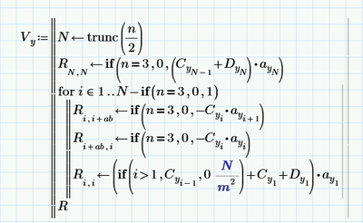

(To:JD_10468629)
Why should Vy be undefined?
It has to be defined if n<>3 anyway,
You could (re)define Vy and Sy to be both [1] in case of n=3 so you automatically get the result [1].
Or even better: Define thes two variables that way right at the top of the sheet.
If they are redefined later, its OK, If they are not, they have their value and you get the desired result [1].
Of course this does not work if you redefine Vy and let one of the elements undefined. But then, why would you do so?

(To:JD_10468629)
is there not a way to make mathcad ignore undefined values in a if or for loop?
No and I also don't know of a reliable way to determine if a variable is defined or not.
You will have to find another way to deal with your problem.
If in case of n=3 the matrix and vector can't be calculated, why not use an if-branch in their calculation and set them to [1]?
JD_10468629
(To:Werner_E)
thanks for the tip! I managed it, looks kinda crude, but works!
(To:JD_10468629)
You could use
if n=3
    return [1]
(or whatever the return value in case of n=3 should be)
in front then then go on with your calculation without considering the case n=3.
No 'else' is required as a 'return' statement terminates the program immediately, so no other program lines will b executed.
