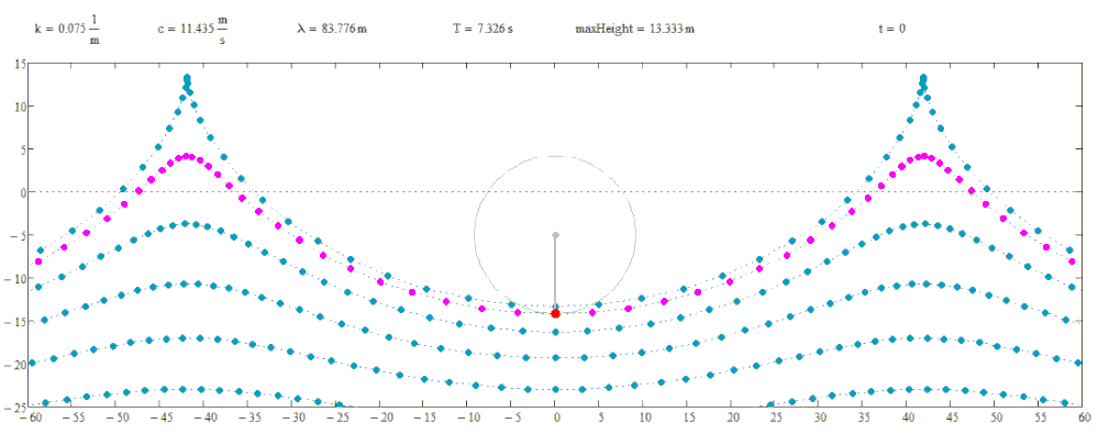

Can i form a trochoidal wave ?
Is there any way to form trochoidal wave from its equation of any values if X and Y.

There sure is a way, but it starts by you entering the equations properly in a Prime worksheet file.
Aug 3, 2023 2:40 AM UTC
I agree with Luc that its you who has to make some attempts first.
Define a value for k first. I would suggest that you use units throughout as this sure is a strength of Prime and Mathcad. k is of dimension 1/length.
Then based on k you calculate c (constant of gravity g is a predefined constant ready for use).
Now you already can define the functions X and Y as shown in your picture.
Now try to calculate and plot a single point - the position of a single particle (defined by a and b) for a specific time t.
Don't forget that a and b must use a length unit, b should be non-positive and t is of dimension time.
If you have succeeded in calculating and plotting a single point, you can go ahead.
You define  a vector  A with values equally spaced, preferably covering at least the range of lambda or more.
Define a vector B of equal size as A with values (b) all the same - you may use something like  B:=-10m+0*A  if you want to see the wave with b=-10m.
Now calculate the x- and y-values for all the particles in this wave:
Note that the function calls are vectorized (the arrow over the expression)
Now you can plot the vector Y1 over the vector X1 and its up to you to format the plot to either show only points, only lines, or both.
The last step would be to stack the x- and y-vectors for different values of b on top of each other and plot them to get what you are possible looking for.
So start creating your worksheet and plots and if get stuck, come back here, explain the problem you experience and post your sheet. I'll sure have a look - if the sheet has a meaningful name and is no named again "Untitled"!
Prime does not support animations, so Prime is only able to give you a still picture for a specific time t.

Two errors:
1) You defined the variables a, b and t with correct units, but you call the function X( ) using unit-less numbers! Why don't you use the already defined variables?
2) You have to type a multiplication sign between the k and the opening parenthesis as otherwise its interpreted as a function k(...) which if course is not defined.
BTW, you should use negative values for b as otherwise you get trochoids with a loop in the wave crest 😉
Here you see the effect of b=+5m
My animation showed 6 waves with b-values from 0m down to -25m
With b=+50m the loop will go up to more than 600 m!
