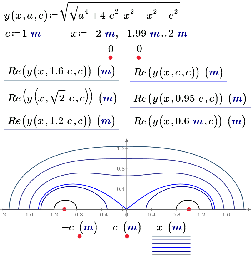

One possible way

@ValeryOchkov wrote:
Thanks, but it's better this way.

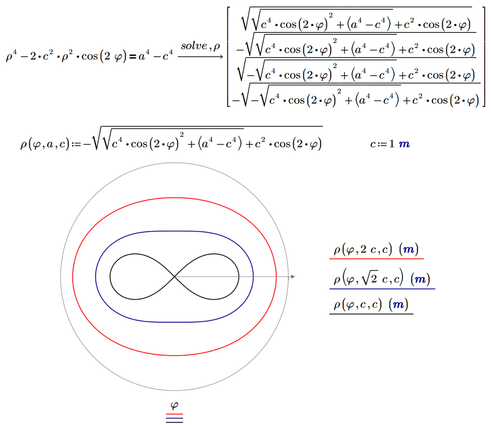

Sorry, but the opposite is true. This is surely the worst way to plot a Cassini oval (which was what you asked for!). One only chooses this way of representation by means of just a set of unconnected dots only if one is either unable to set up an equation or one does not manage to plot the implicit equation. In case of the Cassini Oval you have an equation and can also (see my answer) specify a parametric representation. The use of the relatively simple polar representation of the curve equation would certainly also be possible.

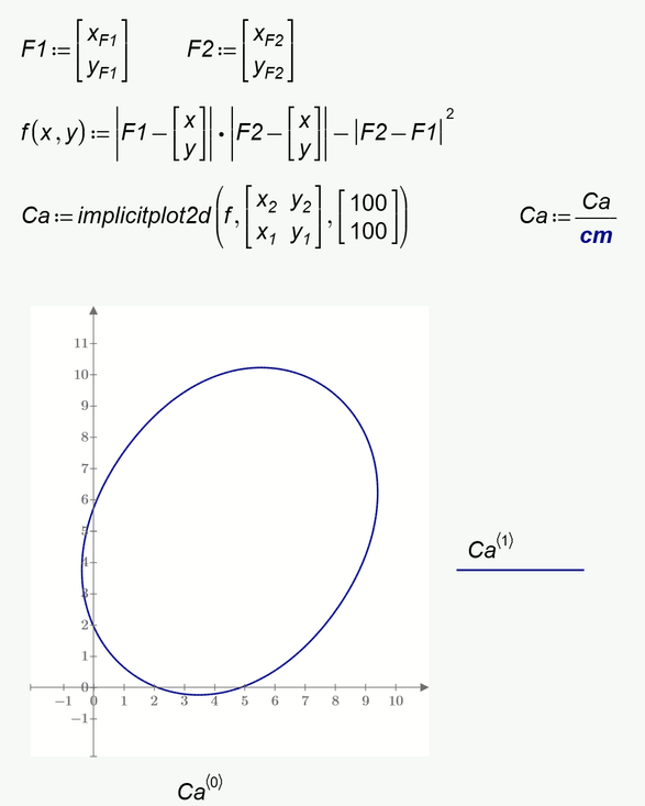

And the function implicitplot2D will not help here.
Why do you thinks so???
Of course you can use this function from Viacheslav N. Mezentsev.
I still  think that using an equation like the parameter representation in my sheet is the better choice anyway, but Viacheslav's function sure is far better and also faster than testing every point in a 1000 x 1000 grid.
I gave it a try and it worked. I had to get rid of the (here unnecessary unit) because otherwise Prime would choke on the unitless imaginary units which Viacheslav uses to separate the line segments. If you really need the units here, you could change his function and add an appropriate unit to the separators - similar to what I did in my first answer by adding the units to the NaN's.

Polar Plot!

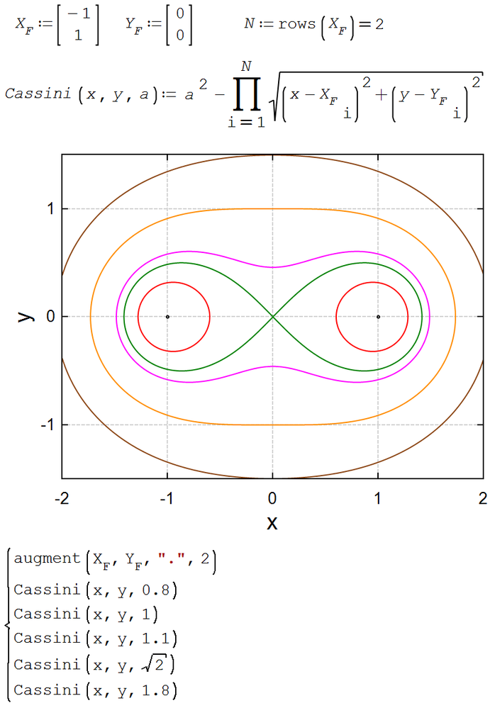

One more thanks to V. Mezentsev program. See one Roots portrait
SMath
