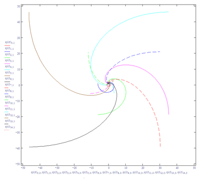

This is the set of equations:
Here is the plot:

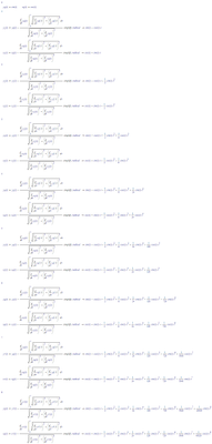

Found a better way to generate the symbolic expressions:
The sky is the limit...
or are we getting close to christmas?
@ValeryOchkov  Maybe you get more results in Prime if you separate the integrand variable ( t ) from the integration limit ( also   t ). As you can see, I've used tau instead of t for one of the two.

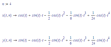

Here are the generating functions for a set that starts with x(t)=cos(t) and y(t)=sin(t):
You get the first pair with:
the fourth:
and number 14:

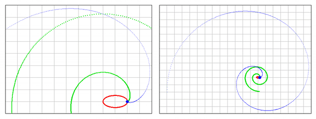

Here is a first try with a numerical approach working on vectors. Its not really satisfying with other base curves, but works OK for curves like ellipses (unless the "order" gets too high). Here is the first dozen from the ellipse suggested by Luc:
Here's the construction of the first two:

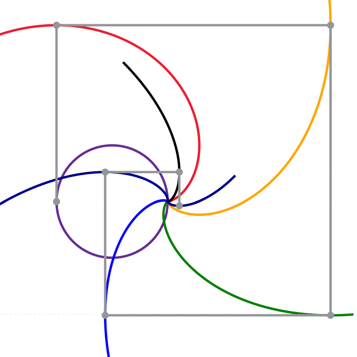

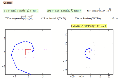

And what about a square not a cyrcle or an ellipes?
@ValeryOchkov wrote:
Fine, Werner! Solution without atimation is not solution!
So why are you using Prime, if you like animations?
Sure! 😄
See my other post with the file attached which you now can change at will 😉
You sure will have to put some work into it as it doesn't work OK out of the box as you can see here:
EDIT: And of course you would have to define first, how you'd like to define an "evolvente" (of a straight line). Normal definition wouldn't apply 🙂
(To:Werner_E)
Forgot to attach the file and the forum software didn't let me edit my old post, so its attached here.
As you may notice a lot of crazy artefacts are created for higher order evolvents (thats the reason I used "points" and not "line" for drawing). Guess this could be because of the bold numerical derivative and maybe could be improved. Its also dependent on the number of points created - the higher the number, the sooner we see strange effects. So maybe some errors are cumulating.
Furthermore the approach fails if the base curve has an apex (a point with zero curvature). In the file you find some examples like semicubical parabola (Neile parabola), astroid, catenary, cycloid).
If the problems could be fixed it would be necessary to make the starting point selectable (at the time its the first point in the data set)  or (maybe as an alternative) make the initial lenght of the tangent selectable.
I don't think I will find the time to fix the file so I attach it here in MC11 format - maybe someone would like to take a closer look at it. Have fun!
