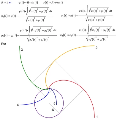

I am trying to build circle Involvents.
I built five involutes, and the sixth, the seventh, etc. there is not enough time and power of the computer - see attachment Prime 6.
I will be very grateful if you can give me a way to make my work.

Hi Valery,
how about:
It shouldn't be too hard to construct the next set from the previous. I see factorials in the coefficients to the various sine and cosine terms.
Here's the plot:
Note that the task gets much more complicated if you try to do this on an ellipse (e.g. leave y(t) as is, and change x(t) to 2*cos(t))...

It is Mathcad 11 with old good Maple symbolocal engine!?
We must use the simplify operator in Prime 6.
Can you have more than seven involutes? Слабо?
With very interesting fractal!

Certainly.
This is the set of equations:
Here is the plot:

Found a better way to generate the symbolic expressions:
The sky is the limit...
or are we getting close to christmas?
@ValeryOchkov  Maybe you get more results in Prime if you separate the integrand variable ( t ) from the integration limit ( also   t ). As you can see, I've used tau instead of t for one of the two.

Here are the generating functions for a set that starts with x(t)=cos(t) and y(t)=sin(t):
You get the first pair with:
the fourth:
and number 14:
You may speed up calculations significantly if you use bold and simple numeric approximations for derivatives and integrals - working on vectors of points, not equations. Of course at the cost of accuracy (especially with higher "order" evolvents).

Here is a first try with a numerical approach working on vectors. Its not really satisfying with other base curves, but works OK for curves like ellipses (unless the "order" gets too high). Here is the first dozen from the ellipse suggested by Luc:
Here's the construction of the first two:

You sure will have to put some work into it as it doesn't work OK out of the box as you can see here:
EDIT: And of course you would have to define first, how you'd like to define an "evolvente" (of a straight line). Normal definition wouldn't apply 🙂

As you may notice a lot of crazy artefacts are created for higher order evolvents (thats the reason I used "points" and not "line" for drawing). Guess this could be because of the bold numerical derivative and maybe could be improved. Its also dependent on the number of points created - the higher the number, the sooner we see strange effects. So maybe some errors are cumulating.
Furthermore the approach fails if the base curve has an apex (a point with zero curvature). In the file you find some examples like semicubical parabola (Neile parabola), astroid, catenary, cycloid).
If the problems could be fixed it would be necessary to make the starting point selectable (at the time its the first point in the data set)  or (maybe as an alternative) make the initial lenght of the tangent selectable.
I don't think I will find the time to fix the file so I attach it here in MC11 format - maybe someone would like to take a closer look at it. Have fun!
