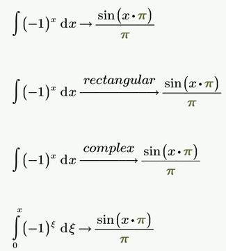

Please see this file. I believe Mathcad gives the wrong answer for the indefinite integral of ((-1)^x)dx.
Let me know what you think.
Glen

I guess you're right:
What version of Prime are you using?
gatlas11-GarnetAuthor
11-Garnet
January 30, 2026
Luc,
I'm using Mathcad Prime 11.
Glen

January 31, 2026
Yes, I would call it a bug in the symbolic engine and its already present in Prime 9 (can't test P8 or P7 as I don't have those versions installed).
Modifiers 'rectangular' or 'complex' don't help and also not writing it as a definite integral

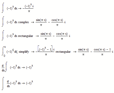

and also
As Luc has shown it works OK in MC11 (with Maple as symbolic engine).
It also works OK in MC15 (with muPad as symbolic engine)
(The definite integral differs just by a constant i/pi which is OK)
