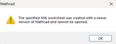

I have reviewed your solution; however, I am unable to open the file in my version of Mathcad (version 13.0).
Would it be possible to convert the file to a compatible format?
I appreciate your assistance.
(To:MB_12486492)
Sure! Fortunately we are using real Mathcad here and not Prime. So its possible to save back in an older version format without problems.
Attached is the file in MC13 format but he pictures in my last post already showed it all, nothing hidden 😉

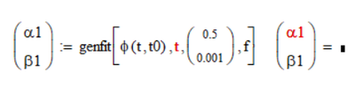

Is it possible to use the function inside Genfit, alfa1(t, t0) = beta1(t, t0), without specifying specific points of the matrices X and Y?
(To:MB_12486492)
@MB_12486492 wrote:
Mr. Werner_E,
I am not sure what you mean!?
The first two arguments of the "genfit" function must be vectors of scalars.
And "genfit" tries to find the best (scalar) parameters (alpha, beta in your case) for the function type (last "genfit" argument, based on the third function argument (guess values).
I am not sure what you have in mind when you write alfa1(t,t0), etc. alfa1 and beta1 are variables with scalar values returned by the "genfit" function and not functions in two variables ....?
I see that you have defined functions alpha_bct and beta_bct in two variables but I can't see how these functions should be used in fitting the X Y data.

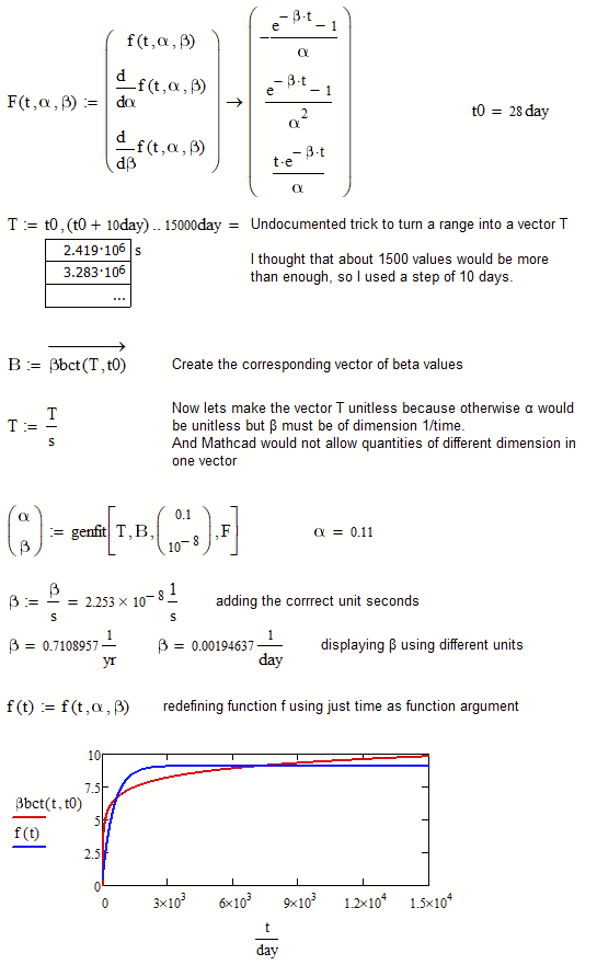

EDIT: I am now stabbing in the blue (or in the dark), but maybe your goal is to approximate the function beta_bct by a function of the type you defined for f ???
Because genfit just works on vectors of values, its necessary to create the vectors of time and function values (T and Beta).
The guess values have to be provided in a vector and a vector in Mathcad is not allowed to hold quantities of different dimensions. Therefore we have to make T dimensionless so that beta and alpha both are unitless parameters.
Then we can use these vectors, your matrix F and appropriate guess values to find suitable parameters alpha and beta.
But then I am absolutely not sure if this really is what you are looking for ...
MC15 sheet attached

genfit fits points to a specific function. So if you want to find a function f of a specific type which approximates another, different function Phi, you have to do as I just had shown - you must create data vectors.
Concerning function alpha(t) and beta(t): Guess this is possible, but probably not the way you have in mind.
Instead of
you would have to define the type of functions for alpha and beta, depending on some parameters and  use these functions in the definition of f
That means that you will have to know or suspect in which way alpha and beta are changing over time
Looks like my arbitrary choice of functions and/or my guess values are not much better than the original constants 😉

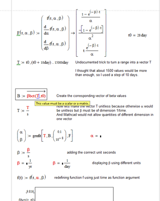

When I try to replicate the same information you used in your Mathcad file, this error message appears. Are there any configurations I should change ?
Thank you for your time and assistance.
(To:MB_12486492)
The "undocumented trick" to turn a range into a vector I mentioned in the comment consist of the inline evaluation, the equal sign right after the definition which you did not type. Therefore T in your sheet is a range and not a vector which is the reason why vectorizing failed.
It can be tricky to resize the displayed vector which is shown after this inline evaluation, though.
This undocumented trick works up to Prime 9, it was broken without any replacement in Prime 10.
A more "legal" way to define the same vector is
