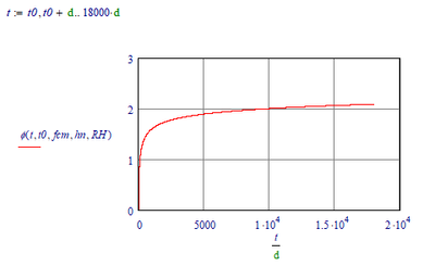

I fail to see the point of curve fitting. Following your sheet I find:
that define:
and:
that define:
to finally define:
So the function you are trying to approximate is actually
With the values:
this plots as:
So the shape of your function is determined with only four parameters.
Why settle for less accurate results in two or three parameters?
