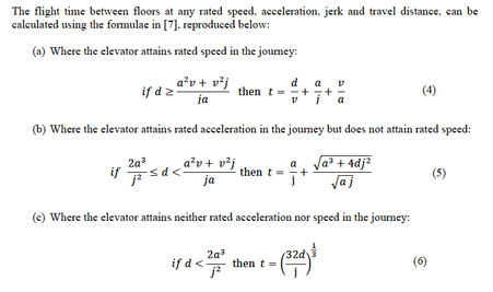

Thanks once more. I have to calculate a time (t) for each of those distances (d) like in picture below. I'm trying to use "if" formula as on attached file. I have an error that the first value have to be scalar. Any idea how I could implement this function and create another matrix with results?

You were correct in the use of the if functions
It is necessary to index d the matrix to get d[i,y each scalar element of d.  This is the source of the error message.
Enclosed file calculates the time and puts them in a matrix.

There's a problem in your middle equation for time!  (One of the reasons I use Mathcad is because of the units; when units don't balance there's a problem that needs to be investigated!)
See attached!

Thank you very much for spotting it. I have taken those formulas from one of the journals related to elevators. I will inform my tutor regarding it and show him that there is an issue with units.

Concerning the unit mismatch which Fred noted, the error in formula (5) in the screenshot you posted here
https://community.ptc.com/t5/Mathcad/Distance-between-floors-matrix/m-p/814280/highlight/true#M202215
is now quite obvious - especially if you look at formula (8) in the pdf you just posted.
In formula (5) mentioned above is should read
Note that the last "j" in the denominator is NOT under the root!

I didn't, Fred did!
As he already wrote its one of the major benefits of Mathcad and Prime that it can naturally deal with units and will choke on formulas which are not unit balanced.
So its normally a good idea to add the correct units. You can run into problems doing so if the formulas you use are empirical formulas meant to be used without units - you would have to use them unitless in Prime as well.
