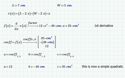

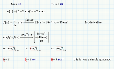

My calculations fall over when I change to inches. Prime 8 Used.
Then won't work when I chage back to cm
ttokoro
(To:ppal)
Add this to eliminate errors after W:=5 in.
2 REPLIES 2
ttokoro
(To:ppal)
(To:ppal)
Seems to be a new bug introduced in P7 or P8.
I don't experience this erroneous behaviour in P6.
Maybe it helps if you activate "Units/Constants in Symbolics" in the Calculation Options.
