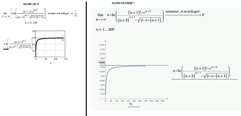

Example M15 vs MP7
-MFra-
Example M15 vs MP7
.... I am overwhelmed with pain .....
.... and now how do I do it?!?!?!

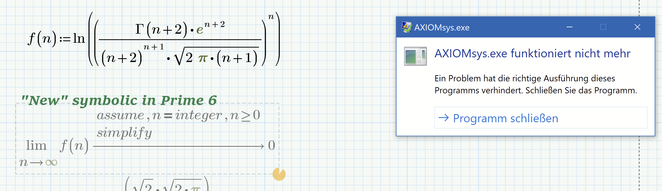

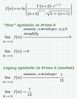

ADDENDUM
By replacing the factorials by the gamma function I get the very same WRONG result in Prime 6, too!
Here is another "nice" experience I had while playing around (still in P6) - its reproducable

Mathcad 11/Maple:
can do without an assumption.
How does Prime7 fare without the 'assume n=integer' ?
-MFra-
(To:LucMeekes)
LucMeekes
(To:-MFra-)
I'd say, report this crime.

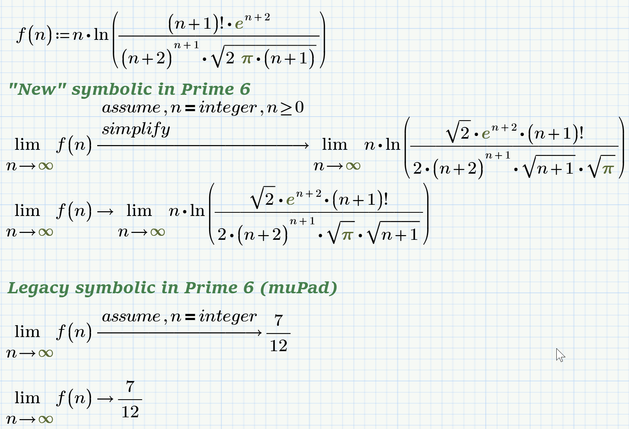

The bug itself is newly introduced in Prime 7 in an attempt to improve the mediocre symbolic engine. The new (free) engine was chosen because now PTC must not pay license fees to Mathworks for using their muPad.
See here how things have changed since Prime 6. As you can see the result of the new symbolic is useless, but at least its not wrong

ADDENDUM

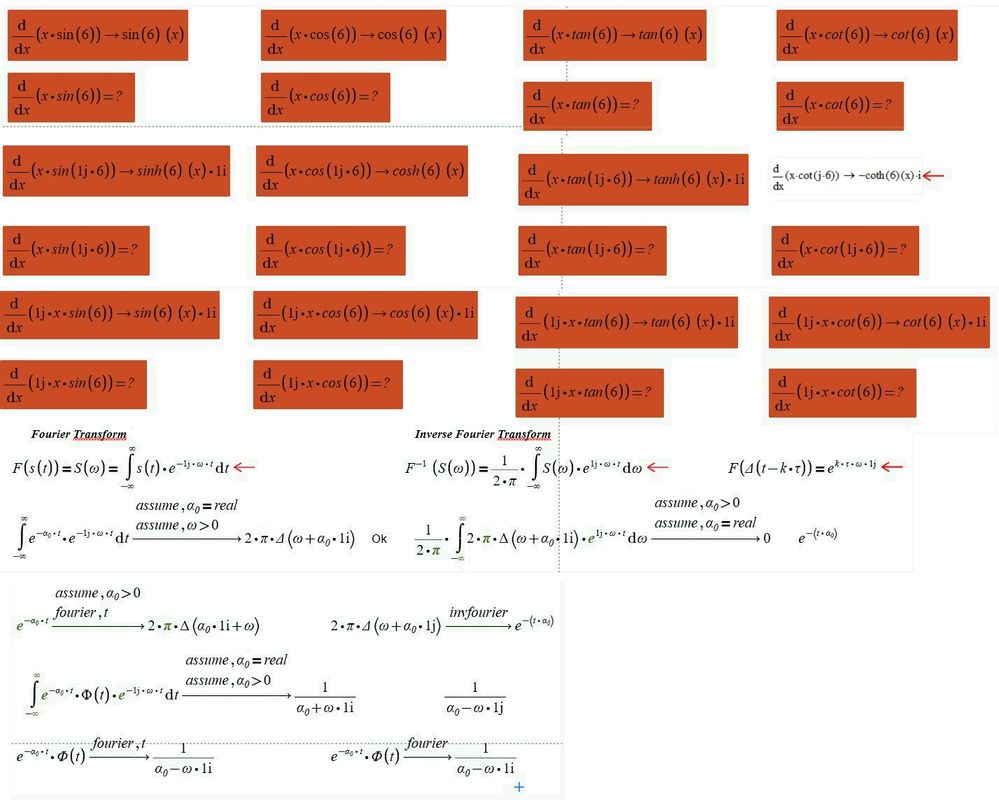

Similar complaints have been posted in the community for years. It seems to me that Werner and others, from time to time, report it to PTC but without getting anything although, if you check, some old errors (see photo) have been corrected, but not all.
There is a more complete list.
((Note that all other software suffer from similar errors but not the same)...)

MP5 works.  So I guess the new symbolic solver isn't actually a solver, symbolic or otherwise. ☹️
MP5 is the old, MuPad engine.  MP6 has (I believe) the new engine AND the old MuPad engine and you may choose and switch between them.  MP7 has only the new in-house built engine.
