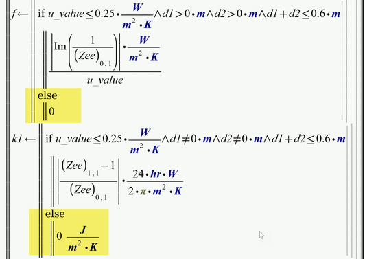

There is a FOR loop for which data is calculated, and there are conditions for selecting the coefficient. If the condition is TRUE, I want the program to choose the k1  and f values to be represented in the augmented matrix in the output.
But, as I can guess, the problem that prevents my loop from performing as it should in the type of input variable - each i-th value of the input variable u-value has to be checked for a condition—if it is TRUE, it goes to the list of output values; if FALSE, it returns an empty matrix.
Mathcad doesn't seem to recognise the particular u-value; it simultaneously recognises all the set of u-values [matrix]. Thus, I probably have the error message "this value must be a scalar."

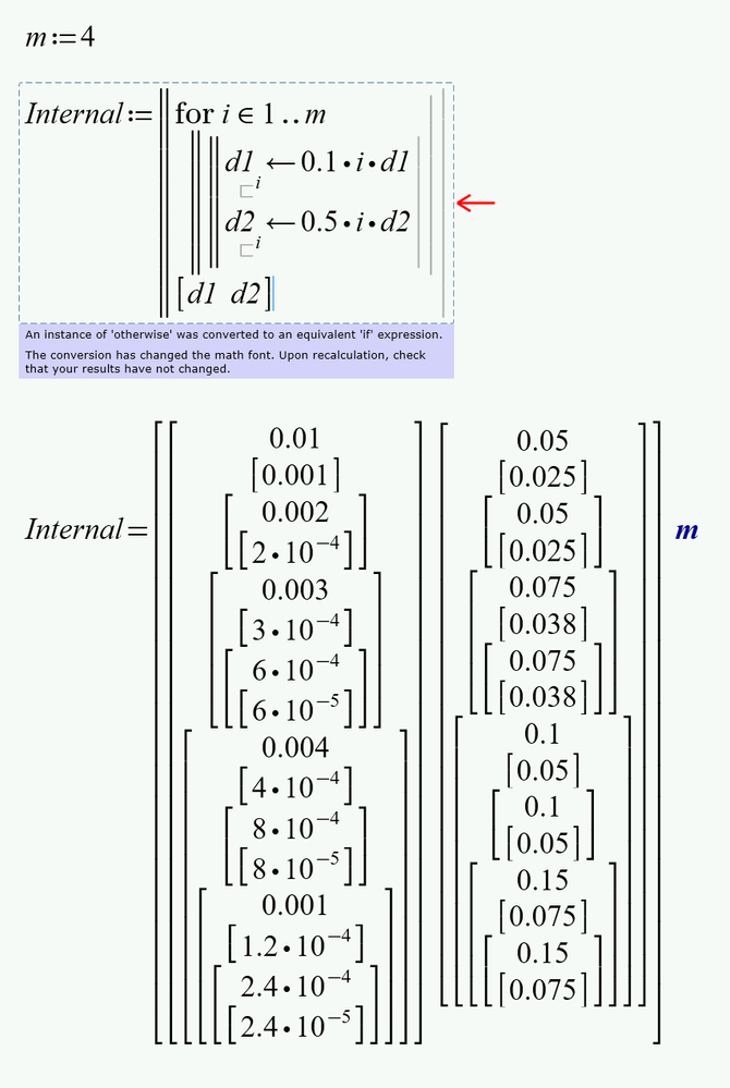

The problem is that d1 and d2 are vectors within the loop.  At each iteration, their next value is the whole of the current value ... which is a vector.  Consequently, Interval creates a deeply nested vector of vectors and, hence, the "must be a scalar" error.
You could try initializing d1 and d2 to be single-element vectors and then using d1i-1 and d2i-1 within the loop; as i runs from 1..n, and your ORIGIN=0, this should pick up the first values of d1 and d2, and give you the desired results.

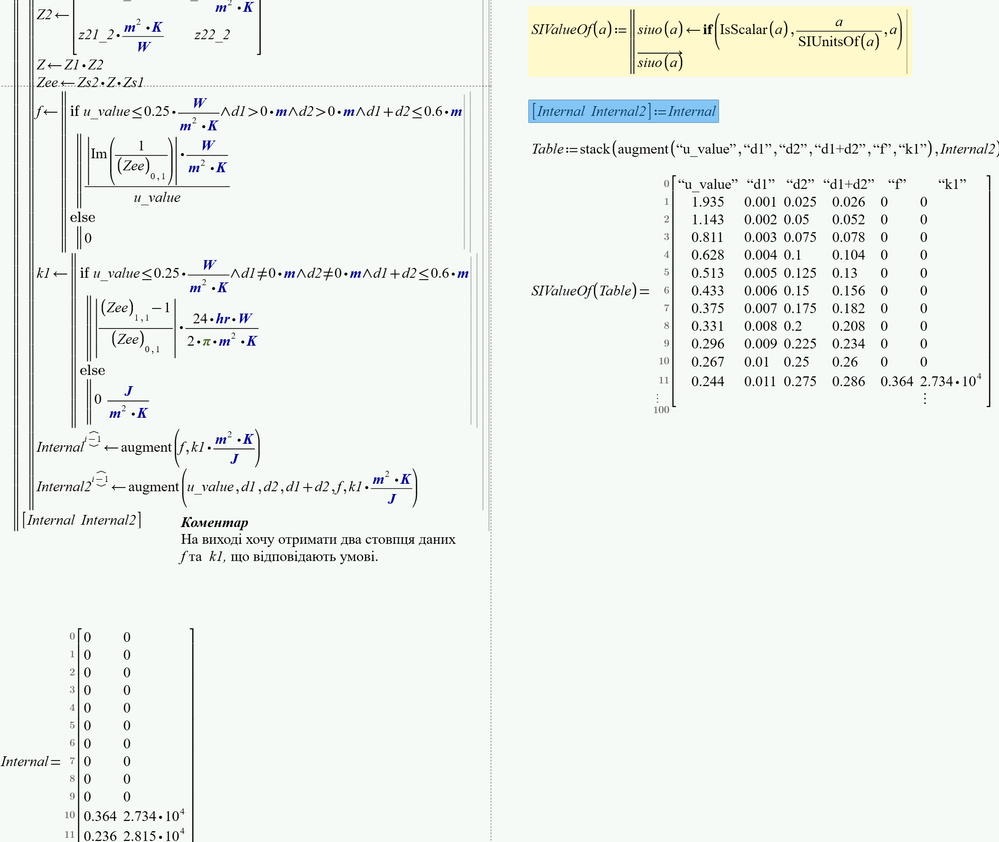

Werner's version of your program returns a lot of zeros because that's what the conditionals select.  I've modified Werner's program to return u_value, d1, d2, and d1+d2 in addition to f and k1 to allow inspection of the values.

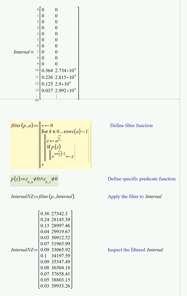

Do you want the program to return Internal with the zeros and then remove them, or do you want it not to add the zero f and k values?
One external method is to apply a filter function to Internal that selects for f and k1 both being non-zero.   There do not appear to be many non-zero values.  Is that what you would expect?

The zeros clearly stem from the else branches in the two if-statements.
The condition seems to be not fulfilled for most values.
I just noticed now that the condition in both if-statements is basically the very same, so this part of the program could be simplified.
As the start values for d1 and d2 are 0.1 cm and 0.5 cm and then are multiplied by positive numbers (i), they never can be zero or negative.
We can therefore omit asking if they are larger than or unequal to zero - they sure are.
I added a header line and added the index i as well as the values of d1 d2 and u_value (for space reasons with units stripped) for your information similar to what Stuart had done. Return values are created only if the conditions are met, so you get rid of the double zeros in the result matrix.
This creates a matrix with just 13 data rows.
I also added a routine Internal.all at the end of the sheet to create all 100 data rows so you can inspect the corresponding d1 and d2 values.
