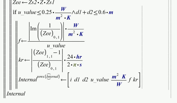

The zeros clearly stem from the else branches in the two if-statements.
The condition seems to be not fulfilled for most values.
I just noticed now that the condition in both if-statements is basically the very same, so this part of the program could be simplified.
As the start values for d1 and d2 are 0.1 cm and 0.5 cm and then are multiplied by positive numbers (i), they never can be zero or negative.
We can therefore omit asking if they are larger than or unequal to zero - they sure are.

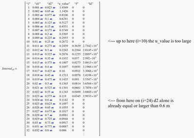

I added a header line and added the index i as well as the values of d1 d2 and u_value (for space reasons with units stripped) for your information similar to what Stuart had done. Return values are created only if the conditions are met, so you get rid of the double zeros in the result matrix.
This creates a matrix with just 13 data rows.
I also added a routine Internal.all at the end of the sheet to create all 100 data rows so you can inspect the corresponding d1 and d2 values.
Unfortunately scrolling in a large matrix is horrible implemented in Prime 😞
But its easy to explain why the output of valid values is just a small matrix:
Our program starts with d1=0,1 cm and d2=0.5 cm and creates 100 pairs of d1-d2 values by increasing d1 for 0.1 cm and d2 for 2.5 cm in each step. The last pair of values thus is d1=0.1 m and d2=2,5 m.
For the first 10 pairs the condition u_value<0.25... is not met.
And for the pairs #24 up to #100 the condition d1+d1<0,6 m is not met because d2 is already too large.
