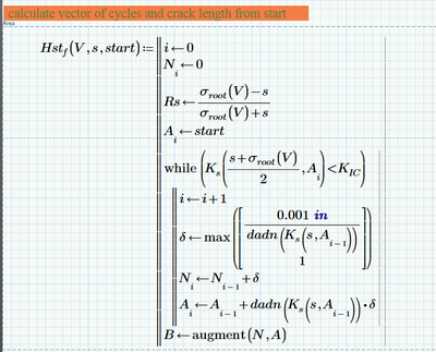

Andy,
Really isn't all that jazzy;  the challenge is to determine when the crack converts from slow growth to abrupt fracture.  For that reason, most of the time the change in cycles is taken in steps as your documentation suggests.
I've dealt with this.  First with pressure vessel steel in thick sections (you're in ship building, so that's probably your area.)  Second in high strength brittle steels and aluminum (helicopters and airplanes.)  I've excerpted things from a real problem.  (Sorry, proprietary info stops me from transmitting the actual document.)  The calculation is cycles to crack rapid propagation.  (Stress is a rather complex function of airspeed, so V is airspeed and I've left off the actual function.)  I've also attached a working version 15 document for crack growth in aluminum.  This was crack growth in aluminum, I found actual data and fit the curve rather than figure out the Paris Constants.

If you look carefully, there are at least two "crack length" programs in what I sent you.

Fred,
Good timing, I noticed that and have worked on the attached in the last hour and these are very much based on your programmes you sent so thanks!
What I do observe however, is that these suggest that by the end of ~8.301E+5 cycles the crack length has reached ~1.1m.
What I would say is this A seems odd and B this does not sit well with the problem I am attempting to solve. Either, my mathematics are wrong or this is a trick question (not inconceivable).
What do you recon is more likely?
Andy
