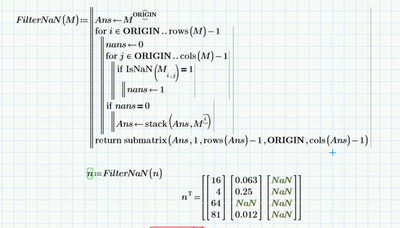

I want to remove NaN from a nested matrix so I can find the average . I tried to use (filterNaN) function but it shows this error
I wrote a program to remove NaN ,, but it does nothing (page 3) in avg sheet

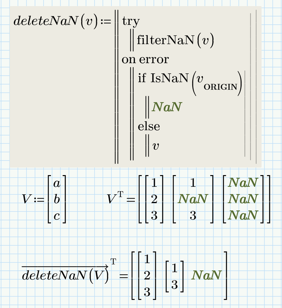

Maybe this alternative mean function could be of help
filterNaN will throw an error if no NaN is found (or if all entries are NaN.
This also applies if you use filterNaN vectorized on a a nested vector.
You may try this alternative function which tried to catch this error - it vas written with vectors (one column matrices) in mind

mean2(), like the original mean() is supposed to work on a vector of scalars, not a nested vector of nested vectors of nested....
The same applies to the deleteNaN function shown above.
Only difference from mean2 and mean is that mean2 properly handles NaNs without throwing an error and that mean2 was written specifically to take one vector argument.
You can use both functions vectorized, though.

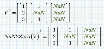

Here is a function to replace NaNs by zeros (why don't you assign zeros right ahead if this what is appropriate for your work?).
It also works for a vector of scalars if you apply vectorization.
But of course it does not work for deeply nested vectors because vectorization works just one level deep and not recursively.
You will have to loop through your data structure yourself!
Either down to the last vector using vectorization
or with an additional loop down to the last scalar

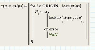

If you still remember how we  got the NaNs >> from this program
from this function which means these NaNs should be excluded , because they don't exist >> so I don't want to include them in the average calculation

NaN2Zero2 just replaces all NaN's with zeros, trying to even ad a correct unit.
It has nothing to do with average values.
It was just my answer to your question "Is there a way to replace NaN with zeros ?".
If you take the mean of the vectors thus created, the NaN's sure are counted as 0.

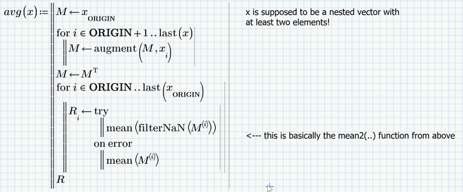

If option 1) is what you are looking for, then the answer was given in form of the function "avg" in the sheet I posted
This routine also takes one element of each vector and then calculated the mean value of them as this is what I first thought is what you are looking for. Later I saw the strange value 0.444 and was confused. You explained that you don't know either about this value but you still did not explain what result(s) you expects and if the vector I showed here [example] was the one you are looking for.
If option 2) is the desired one (after all YOU wanted the NaN's replaced by zeros), then you can use one of the ways to replace NaNs by zeros and then use the built-in mean for each vector you want the average to be calculated.
Again - provide an example or two for the input (as simplified as possible) and manually type in the exact result you expect and explain how to arrive at those value in case its not obvious.

I just only looked at your shorter "YA avg 02.mcdx" and tried to find out what may be needed and so I came up with "avg" and hope that it helps.
