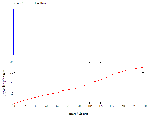

I would rather stay with "largest surface but minimal paper" throughout or with constant side length 12 cm and minimal paper (which would allow only angles from 0 to pi.
Here a numerically derived solution for the latter:

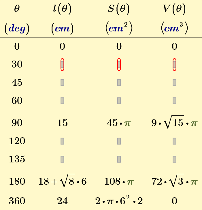

You can add to the table:

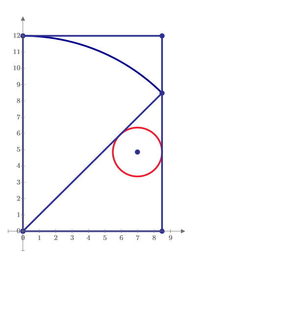

Thanks, challenge this puzzle.  θ=90 degree is the Entrance Exam of High school in Japan. It requires the position of cap and the length of role paper with minimum length.  My answer of the one of 45 degree is here. l=12/sqrt(2).

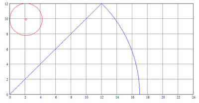

When cone and cap  have 'largest areas' (possible, given the width of the paper roll)
I get this for theta=45 deg:
And here the paper length required is 12 *sqrt(2).
The smaller theta, the longer the paper required...
But also, the higher the cone.

This is my answers I got. Blank answer is already calculated but not shown to fun of this puzzle. (Or want more minimum length of roll paper to need.)

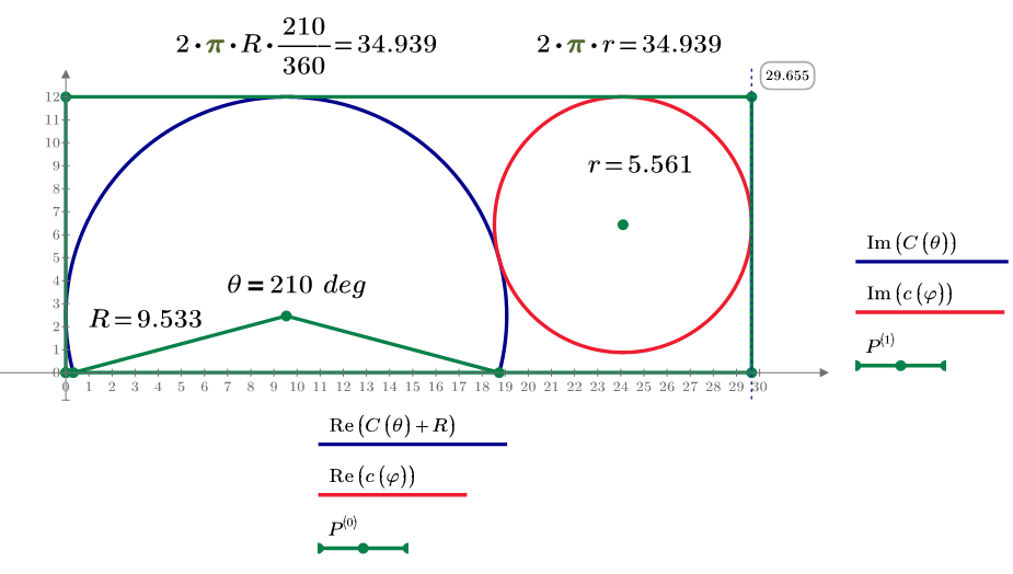

My answer of θ=210 degrees. Using 12 cm width and minimum l=29.655 cm.

Thanks. Please share your worksheet. This is what I want to solve. The function is not linear or simple function but have many turning points. 😀
(To:ttokoro)
Here you are, but you will be disappointed as the sheet is not only bit of a mess but the paper lengths are not really calculated 😉
