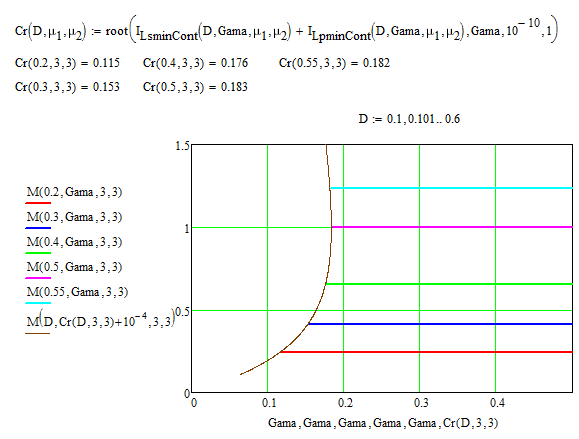

The following should help (worksheet attached:

That was a great solution. You saved my time and my peace. I am SO THANKFULL, really.
I was about to lose hope and was gonna migrate to Matlab where I know how to work with vectors, and "for" structures more easily. I was gonna sweep the function M  until I would find a Gama. But still, it would take so much time.

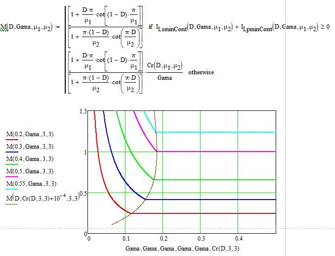

By the way, the real curve that I wanted to plot is this one:
 That's why I needed to find the "Gama" Value. The curve that defines the region is fantastic and improves much more the plot.
