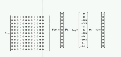

Hi Terry
I hope you are doing well . I know this very old question , I tried to use this function again  , but I don't know why I'm getting errors. Can you help me to fix it  > I couldn't upload the sheet          > BTW it works in the other sheet ok.

@YA_10963798 : According to your problem - you don't show what the error message is, but chances are its a "division by zero", right?
From your screenshot it looks like at least one value in your vector "ns" is zero (actually most elements in "ns" seem to be zero) and so its natural that you get an error if you use this vector in the denominator of the vectorized expression.
What did you expect from  0/0 (all elements but the first)?? What would you like to see as a result if the value in Sum is positive but the value in ns is zero (like 1/0)?
You could catch the error with "try...on error ..." and return a value of your choice (maybe 0, maybe NaN) in case the division fails. For example
And you sure will want to replace 12345 for something more meaningful 🙂
