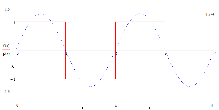

The Nt seems to be the number of harmonics, if I am not misinterpreting it.
Why for the first harmonic Nt should be 2?
Nt shouldn't it be 1 for the first harmonic?
The image above shows the first harmonic and for that Nt needs to be equal with 2.
LucMeekes
(To:Cornel)
Your sheet calculates the first two harmonics of the signal.
BUT, the Fourier sequence of a square wave only contains odd harmonics. So from the first 2 harmonics only the first is (and should be !) visible. The second harmonic is zero.
If you set Nt:=3 I suspect that you should see the result of first and third harmonics added.

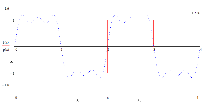

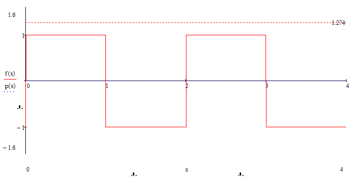

Cornel
(To:LucMeekes)
I know that the square wave signal has only the odd harmonics, but the first harmonic is the first harmonic, and it is odd:).
What it's your opinion about this sequence?
LucMeekes
(To:Cornel)
My conclusion: There's a     2    missing in each of the sin()  and cos() arguments of the Fourier functions that you are using.
The correct function to create a sine of frequency F is not sin( pi * F * t)  but  sin(2 * pi * F * t).
Now your n has to step twice as much paces to run past all harmonics.
