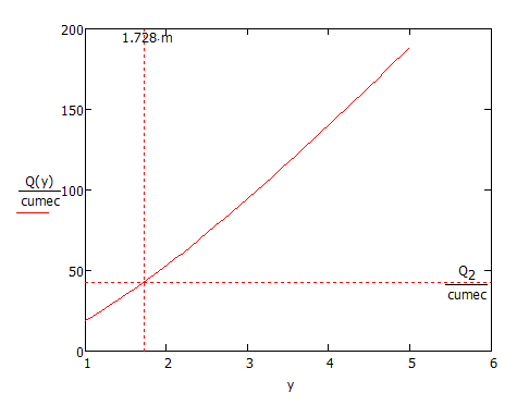

Hi
I was trying to develop a function to calculate flow depth in D-shaped Tunnel. My attached sheet calculates correctly for First Tunnel section. However for second tunnel, It is giving wrong result. In fact it is not changing parrments of tunnel, which I intend to.
please have a look at attached version 14 File.
Thanks in Advance
A. Prasun.

It would be better if you posted the worksheet (you have to zip it first). Based on the pdf, I suspect the problem is the guess value. Get rid of the guess value y1:=1m before the solve block, and add y1 as an argument to the depth function. Then you can try different guess values further down the worksheet by changing the last parameter in the function call.

Given your math, the solve block is returning the correct answer:

Actually it is giving answer for tunnel of bigger size ; for B=H= 8.5 m and not for B=H= 6 m.
the answer remains same even if I modify the values of B h or slope.

One things I noticed ist that your function depth(..) has 6 arguments but none of the first five arguments are used! All your calculations use just the values of B,H, etc. which are defined at the top of your sheet. The only argument which really influences the calculations is the last argument "dis".
This may be the reason for the wrong result as you provide differnet values for B, H, etc when you call the function the second time, but the function still uses the values defined at the top.
You would have to make Q a function with all those arguments, too!

I tried inserting y1 or guess value of flow depth in function but still same issue. wrong answer.
The function is not working if i modify the variables ( change the size or slope of tunnel).
