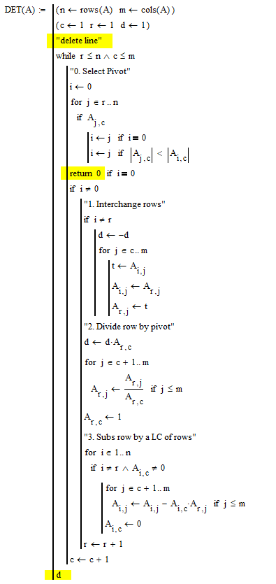

Just the determinant?
So how about a small modification in Alvaro's RREF?
Sure could be done more efficient, but for a quick hack it seems to work OK. No error  check (matrix square, etc.) is done. I simply changed the program to return 0 if no suitable pivot element could be found.
It also works symbolically, at least as long as only numbers are used. It fails symbolically when variables are used because the if-conditions can't be evaluated symbolically without knowing their actual values.

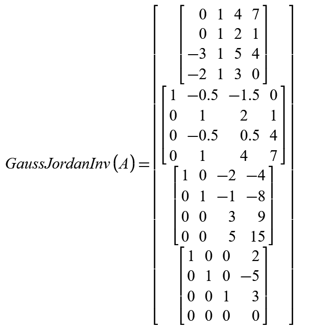

Many thanks for your response, Ttokoro. My Mathcad 15 with your code is the following :
                                                    ___
     But I still got stuck to keep going to write a code for symbolic evaluate a DETERMINANT of a matrix above. My question is "How to write a code for SYMBOLIC evaluate a DETERMINANT of a matrix and with a Gauss-Jordan method or any other idea."
    Best Regards.
         Loi.

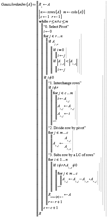

   And a similar code using Gauss-Jordan method, in the forum, is :
  But I would like to have a symbolic evaluate result is : ==> 0

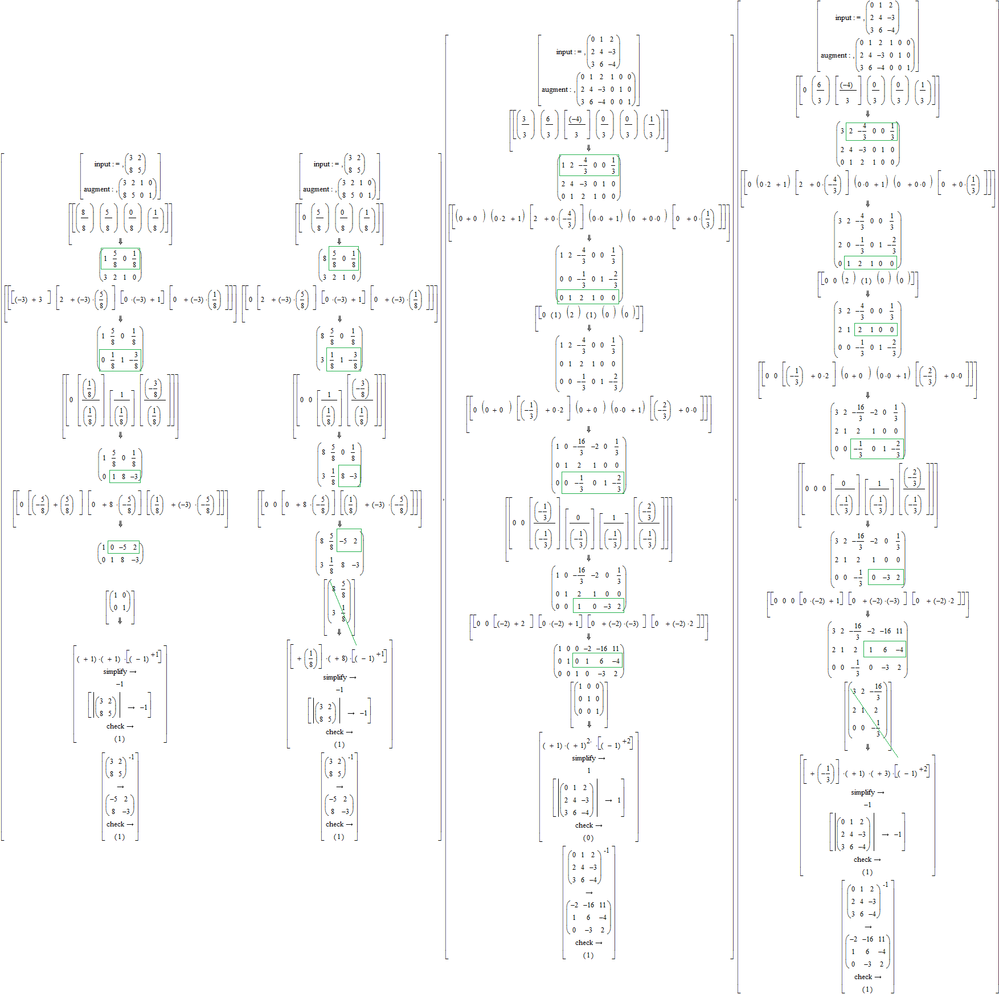

   I really appreciate your time and help, Werner. 😊 🤔 🙄 especially your explanation.
And I guess now it's time keep going with Alvaro's RREF and modify his CODE for inverse of a square matrix. ( I guess I would still be helped more ... ).

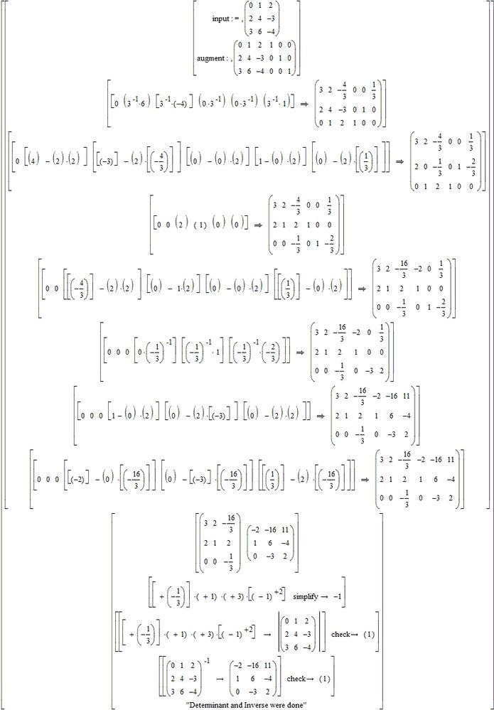

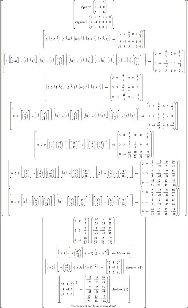

A small modification in Tom Gutman's det( ) ?
for symbolic evaluate result.
