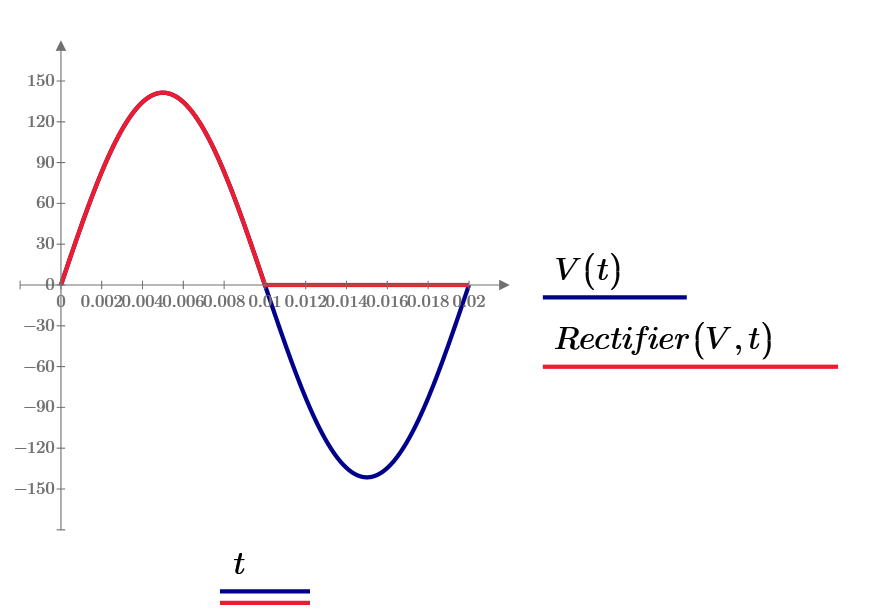

This is for Mathcad 15 although I would like to apply later to Prime 8.0.  My goals are for all of the boolean variables to be active for all portions of the sheet.  I want to defeat the top-down, left-right programming in the sheet.  See attached.

I see what you are doing.  And if I employ that same method and order in my boolean equation, I don't get and error.  But I don't get a result either.  See below
(To:Snowshoeman)
Get rid of the parenthesis and also post the Mathcad sheet rather than just a picture.
YES!  Getting rid of the parenthesis allows the equation to work with the global variables.
