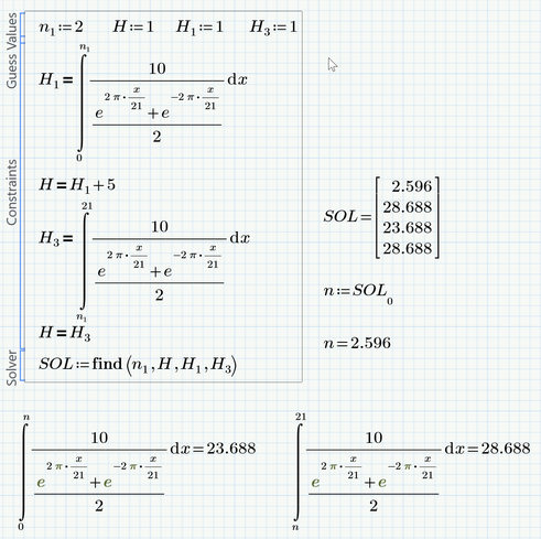

I have a formula which defines water-pressure on a surface depending on depth and wavelength.
To find the total force I have defined an integral.
I want to find the depth beneath the water level where the resultant is located.
I can do this manually by guessing values but I would like the program to solve this for me.
The only variable here is the depth for what I'm understanding by looking at my functions.
Can someone help me understand what I'm missing in the attached calculation?
Regards
/Tobias

I just wanted to answer your question about
The problem is because you introduced three intermediate variables H, H1 and H2 in your solve block, which initially are unknown and undefined.
Because of that you would have to solve for these variables as well and provide guess values, even though you actually are not interested in their final value. After all you have four equations in your solve block, so solving for four unknowns may work well (and it actually does):
But again, I won't suggest doing so.

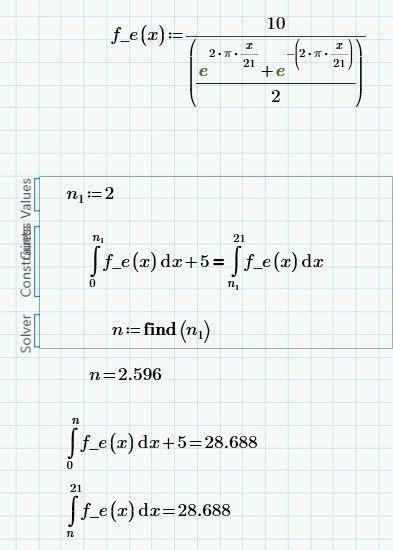

I am not sure if you maybe need the very same calculation multiple times and with different values for total height N (21) and height H2 (5).
If so, you may consider using a little function with these values as argument. My suggestion uses the "root" function by providing a range (0 to N) and so is self-contained and needs no external guess values:
Not sure about the meaning of the "10". You may add it as a third argument to the function if necessary
