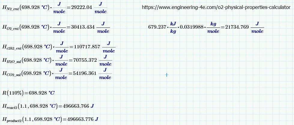

I want to plot the adiabatic flame temperature of a mixture, given the excess air present but I don't know how to tell/write the program to find the value given the excess air.
I'm using Coolprop's fluid properties libraries to get the enthalpy of the mixture and mathcad prime 7.

Thanks it works but it still doesn't show the correct graph. For R(100%) it gives correct value but the adiabatic temperature should decrease exponentialy, not increase. I tried putting T2<650C on the solve block but it doesnt find any values outside the R(100%) which is false because  I have done it on paper before.
Maybe is the way Mathcad and Coolprop work together or an error on my part.

You are right, its not an Iterative problem. It must treat each cycle as a new one and find a new T2 each time but as it is, the program doesn't find the correct values. For example when ex2= 110%, the constraint of the solveblock isn't true. Hreact2 and Hproduct2 are not equal.

Downloaded the Mathcad 15 version of CoolProps and installed it.
Rewrote the worksheet in Mathcad15.
There are some subtle differences between the older Coolprops Mathcad 15 and Coolprops Prime.
Putting the units the same for both versions does not get the same results.
Oxygen is off by a factor of 4, Acetone is off by around 10%. Others are equal.
Mathcad 15 does not solve the solve block because of the differences in oxygen value in Mathcad 15.
The Coolprops Prime value for oxygen is the more believable?
So a lot of work for not much gain.  Cannot help any more.
