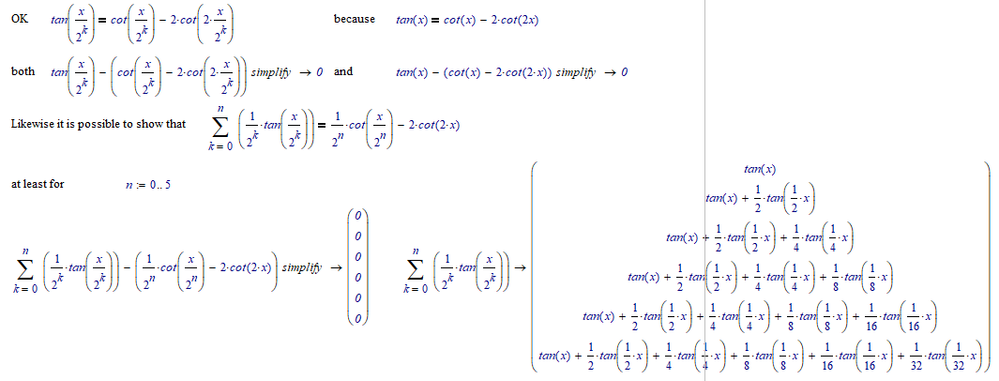

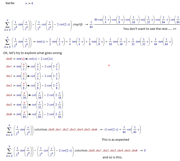

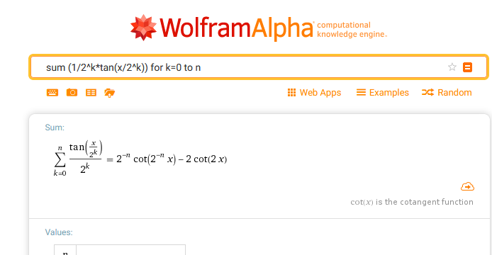

Best answer by Werner_E
Yes, the simplification is correct but Mathcad's abilities are unfortunately very limited when it comes to symbolic calculations. Especially when compared to more advanced systems like Mathematica or Maple or even whem compared to Uncle Wolfram (limited mathematica engine):
I am surprised that even Luc did not succeed as he is using mathcad 11 which includes an older version of Maple to do the symbolic calculations.

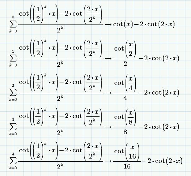

You're right, but what I want is to come up with a simplified summation result like this:
For this I manually use this property:
How can I implement it to get the desired result??
