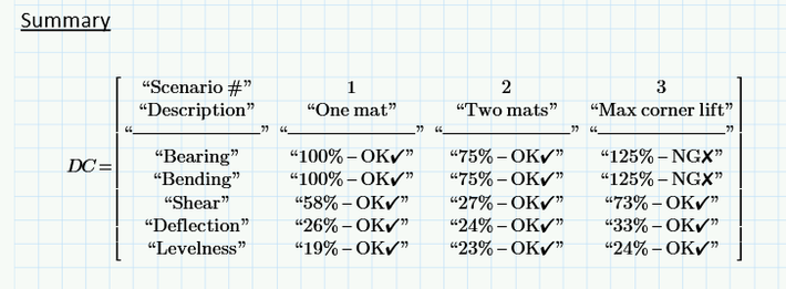

@AP_12953245 I see that you want the results in a table but to remove the variable because it is redundant.

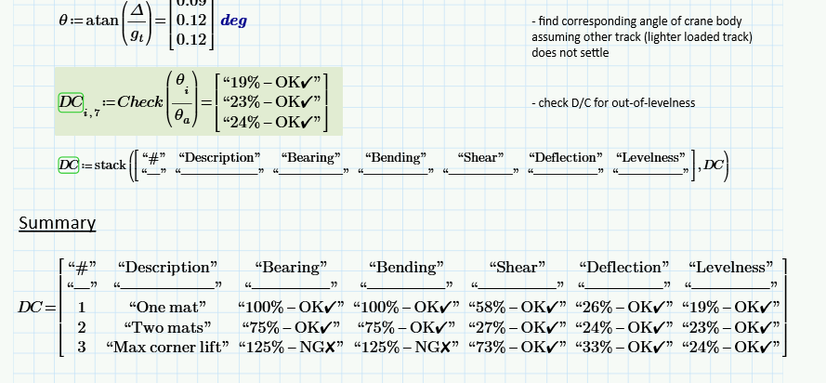

I have a suggestion that I use quite often to display a not-so-large tables of results.  I compile my results to a matrix and add row and/or column headers directly.  I still have to use a variable but you can always use a short variable.  In the end it's about displaying results in a grid .  If the matrix is too wide, then maybe transpose it and modify your headers.

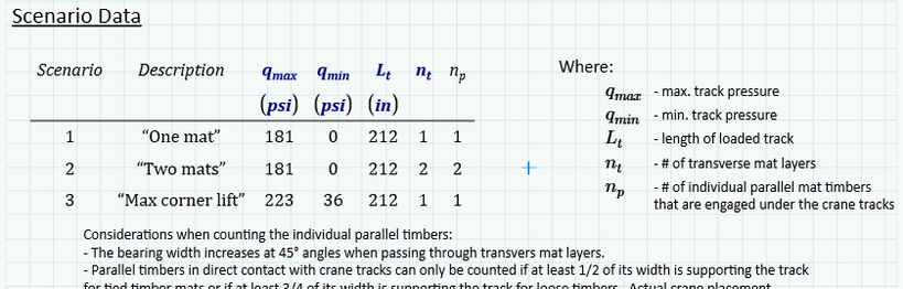

My input data uses the nicely formatted "table" feature (I wish my output looked similar):
And here is my summary table after all the calculations are done.  In the summary table I only need to know the D/C values for each check and I use the OK/NG text because, for me at least, it is easier to spot the problems.  I sure wish we had coloured extended ascii characters as the Mathcad font.
I just tried transposing the table and quite frankly I like this summary table better for this calculation sheet.  I usually do not have that many scenarios, but I can spot the problems even easier.  As you can see, the direction of the table is up to you to make the output look best:
One problem I have is if I have multiple columns of different units.  Mathcad does not allow you to choose your default units other than the base dimensions in SI, US and CGS.  In those cases, you may want to strip the units and add the units as text in your header row/column.
