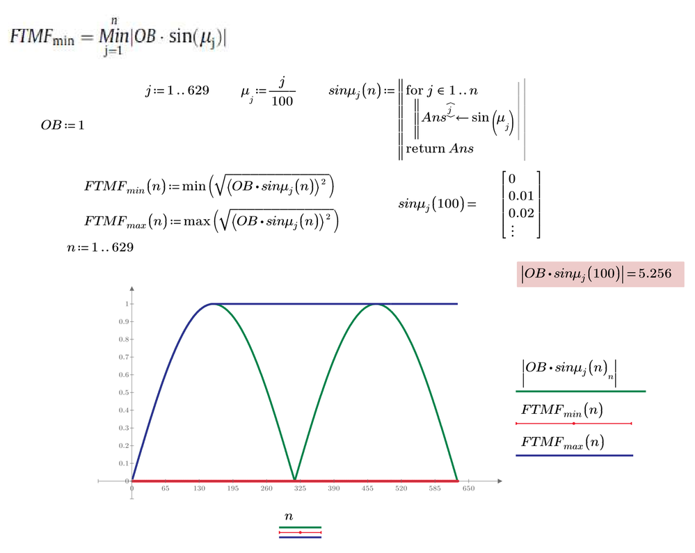

@terryhendicott wrote:
Could you elaborate?
Are OB and uj scalar, vector or matrix?
real or complex?
A definition of what Min is supposed to do would be good, plus a couple of examples, and/or link to a website giving such.
However, in general, then you can't write a function such as Min in the format that you show.  Mathcad has the summation and product operators, but AFAIA has no general iteration operator (apart from range variables and the for programming operator).
If OB can be a vector, then you'll probably need to employ the vectorization operator to ensure element-by-element rather than vector scalar multiplication.

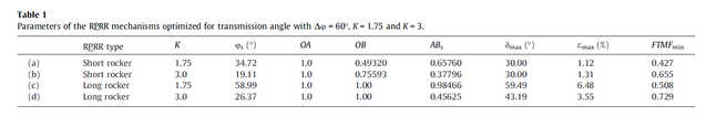

I have attached the PDF I used for the calculations, along with the Mathcad sheet. I hope this helps clarify what I am looking for

I have attached the PDF that provides the reference for these calculations, along with the table, as well as the Mathcad sheet where I have performed the calculations. However, I am still unsure how to solve for emax and FTFMmin in Mathcad. So far, I have calculated values up to the ABs. I appreciate your response and support, and I am currently reviewing the method you suggested to find these values.
