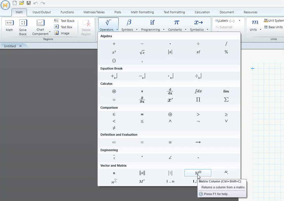

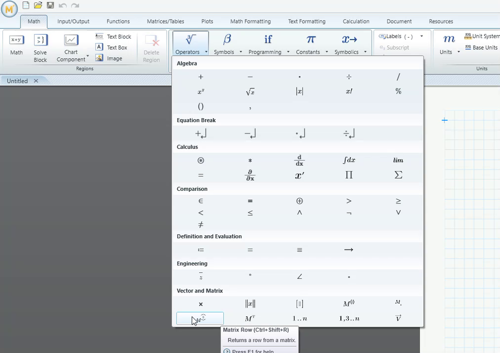

rows() and cols() allow you to find how many.
To extract rows and columns there are two possibilities
One is the row and column extractor/inserter functions
The second possibility is the submatrix() function you can look up in help
Cheers
