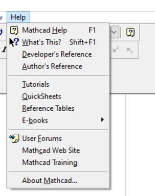

ppal
(To:ptc-6809773)
See if you can find it here:
Go to Help and Click about
