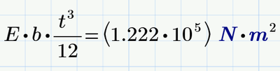

Another way (independent of the value of ORIGIN) to do the sum without a range variable (as shown in the other thread) and without a summation index is shown below. Because two vector elements (E and t^3) are multiplied, we have to use vectorization (The arrow over the expression) as otherwise Prime would calculate the scalar product of the two vectors.
The latter would be an ever shorter way to calculate that value without an explicit sum:
Nonetheless I wouldn't suggest doing so as its absolutely unclear and not universally usable.
