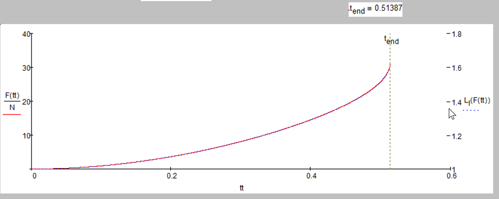

The problem is not the if-function you used.
The error message says something about an unstable problem resulting in a step size too small and suggests that you reduce the integration interval.
If you follow this suggestion and set t.end to 0.5 the solve block perfectly works.
Looks like the solution curve has a tendency you shoot up vertically at the new end value which makes the solve block fail if t.end is larger:

Yes, but thats not equivalent, thats a completely different function .
As already written above, the if function is NOT the problem.
E.g. you may use
with success, but if you use lower values than 66.323N for "limit", the block gets too unstable and fails.

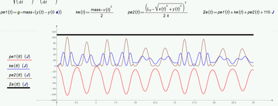

Questions:
  • How calculate the potential energy of the link?
  • Why we have an error on the board from the elastic to hard link?
  • Can we use the logistic function?

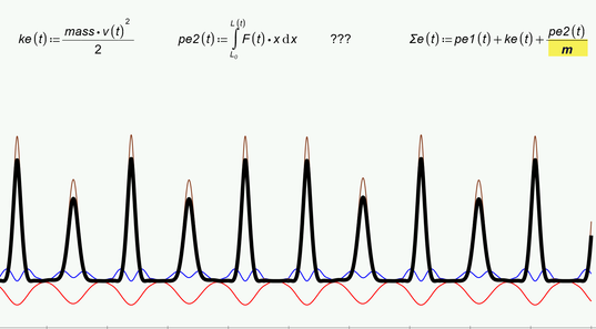

There is a unit mismatch when you add the signals:
Yes! The formula is wrong! I need a correct one!
The sum of three kind of energy must be constant!
In my opinion the mistake is in the definition of the elastic constant: the units are N/m=kg/s^2.

I agree that the additional factor x in the integral (pe2) was wrong and caused the unit mismatch.

Thanks!
But the sum of 3 types of energy must be constant!
See please the case with the linear Hook law

In general, we try to understand something when something is wrong. You could "waste" a few words, to say that in the worksheet you use "spring compliance" and not "spring stiffness".
