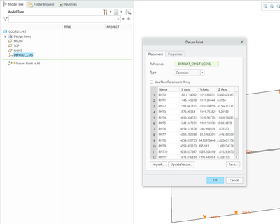

I have created a set of Datum Points in Creo. In my case there are 28 points, from P0 to P27. Those points have been imported from a .pts file.
Originally, there were 28 points from an xls file, which i copy pasted in a .txt file, I renamed that file to .pts and imported as shown in the screenshot.
 So in Creo i got a single feature (Datum point id 66) that has all those datum points.

Here are the files. The part and the coords files (just a simple text file with .pts extension)

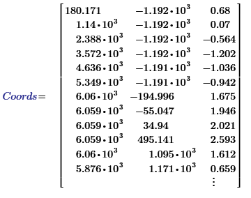

LucMeekes
(To:GS_8802941)

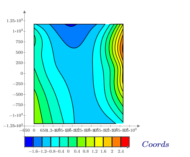

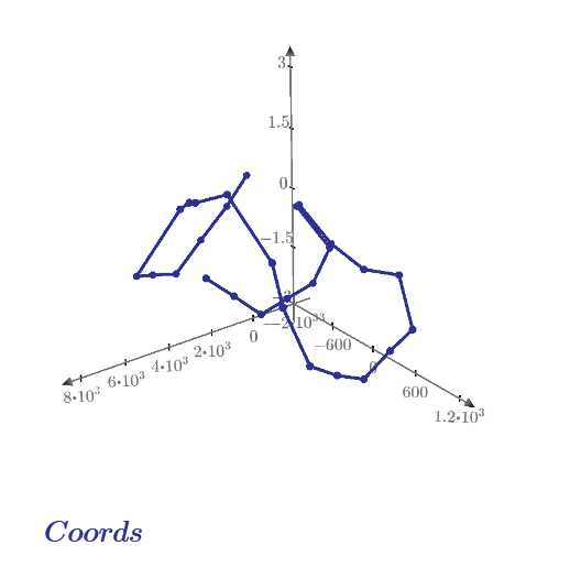

Like this:
Then:
