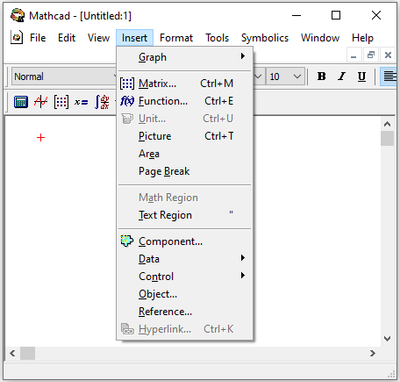

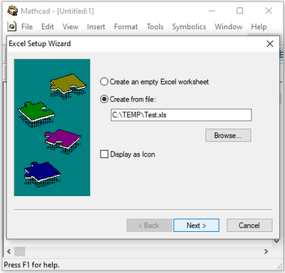

(real) Mathcad, or Prime?
Excel file:
Mathcad:
Raiko

Assuming you have a full license for Prime:
what if you do the trick in Mathcad and then convert the sheet to Prime?
