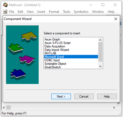

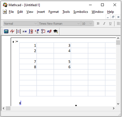

April 23, 2024
Hi Raiko,
(real) Mathcad, or Prime?
Excel file:
Mathcad:
