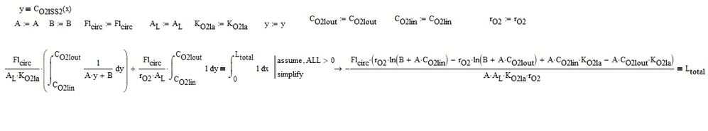

Hey guys,
I'm new in Mathcad and i have some derivatives that i already solved with ODE solver.
However, i try to solve the equation by hand and i want to try simulate this integration to compare if the results is same or no compared to the one that ODE solver gave.
But i don't know how to find the solver for integration, can you help me?
I attached my document. Thanks in advance

Hi SavitriN,
The integration variable can not be a function in Mathcad.
You could proceed as follows:
Yeah, i thought so... Thanks

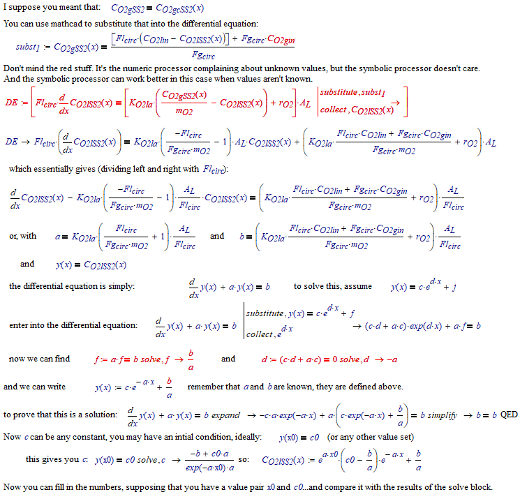

LucMeekes
(To:SavitriN)
Does this help?
Yes, i will try your approach for the problem.
Thank you
But i have a question, which value should fit the C constant?
is that C value equals to the initial concentration at x(0)?
