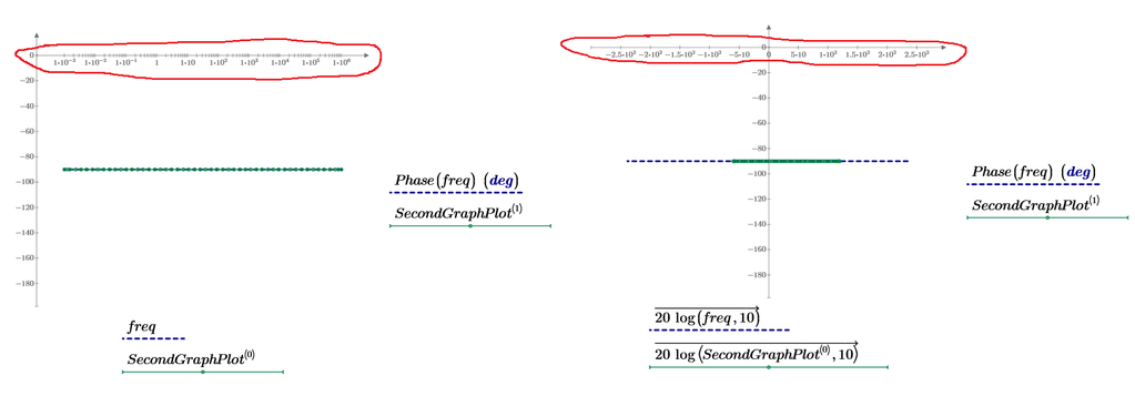

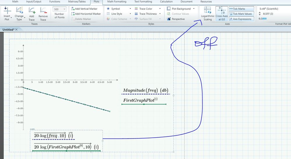

My question here is: how can I make the x-axis of the frequencies (freq) be the logarithmic axis (Log10), but without using the Logarithmic scaling option from the menu?

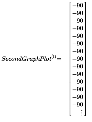

Same thing for the Phase plot:

I am not sure what your problem is - is it the very last plot??
You simply have to change the scale values to see the plot.
Either manually change the three values (first, second and last axis tick) or delete all three of them to let Prime choose its own scaling.

Shouldn't the x-axis look the same for both plots?
The second graph (without using the Logarithmic scaling option from the menu) seems to be shifted (or something like that).
Sure not!
If you use "normal" values x and a logarithmic scale you will see, e.g. 1000.
If you use 20*log(x) at the same point you should just see 60.
