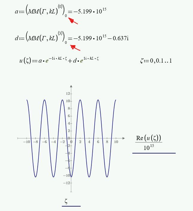

I have just started using Prime 7 instead of Mathcad 15 and have to convert all my files. The issue is after solving a system of equations, the solutions I get are part of the solution vector I guess. I can perform calculations but cannot plot due to the error mentioned in the title. I have seen similar topics here, but I cannot find a way to solve my issue. I figure it is simple and straightforward.
The file
is attached.
Thanks in advance.
Ali
Matrices of one element are formed as part of the calculations.
Simply use the zero index to get a number for a and a complex number for d.

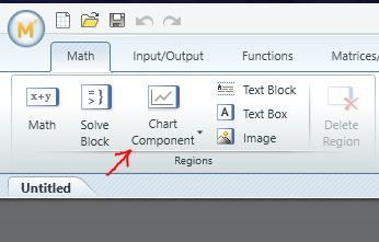

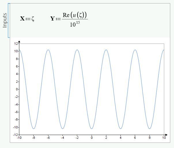

There are two ways to plot in Prime.
a) Plots | Traces | Insert Plot -> This gives you the plot type used.
b) Math | Regions | Chart Component -> This gives a more adjustable plot.
The chart component when you double click it brings up the edit window of the plot.
In edit window you can change number of ticks, add labels, add legends etc
I have added a chart component in the file to show you.

You used the column selector to access the individual elements of the 1 x 4 matrix calculated by MM(Gamma,kL).
That way you always get a column, a matrix, even if its only one row high (1 x 1 matrix).
You should rather use normal matrix indices
or you may also assign the output of MM(Gamma,kL) to a 4 x 1 matrix of individual variables:
