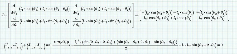

Hi community
in this simple example,is shown how Mathcad help me to find a singularity value (det J = 0)

Is there any question you have???
Why do add and not subtract. Furthermore it looks like you ran into Prime infamous auto-label trap and will have to manually label all variables the same.
Is there any reason you are not using the built-in "Jacob" function?
Would be straightforeward - here done in MC15

(To:XDN)
First of all you have to correct you error and change the plus sign to a minus to calculate the determinant the correct way.
You may also use the matrix determinant operator |J| or ||J|| to do the job.
If you still do not get the simplified result shown in my previous answer you have to look at the labels of all of your variables theta1 and theta2 and change them manually so all are the same - either all "variable" or all "-" (which means "automatic"). The symbolic engine does not like variables which are labeled differently and treats them as different variable which seems to be the reason why in your pic theta2-theta2 is not simplified to zero, etc.
As already written above using the "Jacob" function (and the determinant operator) would be the most natural way but as I have notice it seems to be broken in the new symbolic engine. So if you are using Prime 7 you have no option to switch back to the legacy symbolic engine and if the bug is not already fixed in P7 you can't use the "Jacob" function.

I converted the MC16 to Prime6 and I had to realize that once again Jacobi is one of those things that are broken in Prime. This time its the new symbolic engine which fails. In Prime 6 we still have the option to use the old symbolic engine (muPad) so we can compare:
Legacy Symbolic Engine:
New Symbolic Engine  (Axiom fork)

(To:XDN)
Its a bug in the new symbolic engine (at least in Prime 6, thats all I can say). If its still present in P7 and if you have confidence in the software developers and believe that it will help, feel free to report the bug to PTC.
And the method of providing the partial derivatives manually as you did should work OK as soon as you work around the auto-label problem by changing the labels manually and as soon as you calculate the determinant the correct way or use the determinant operator instead.

(To:XDN)
OK, I further looked at the problems with Prime and I still consider it a bug in the new symbolics but there is an easy workaround.
The reason for the bug seems to be that the new symbolic engine is not always able to determine correctly the number of arguments in use. So the workaround is to just use the optional third argument of the "Jacob" function and tell Prime the number of independent variables in use.
There is a further problem in Prime when we try to solve for theta2. Primes new symbolic seems to not like vector indexed variables to solve for. Substituting the vector element for a "normal" variable seems to cure this problem.
Prime6 worksheet attached
