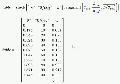

Dag Luc,
Dan zegt het 0, dit betekend volgens mij dat het geen range is. kan ik dan op een manier zien wat het wel is?

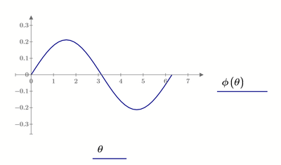

3) making plots
So using a range as a function argument is perfectly OK when creating a plot
and Prime even is willing to display the values calculated (which may be misleading...)

So to create something like a table of values you should use vectors.
 Starting with Prime 11 we have a convenient function "vec" to do so.
The three function arguments are the same as you used for creating the range.
One word of caution because you named the second value θ.1stap. In a range definition and also in "vec" this second value is NOT the desired step width, but rather the second value in the list created. Its identical with the step width only if the first value is zero!
"vec" creates a true vector (or more general a matrix or an array)
Now you an use this vector as argument of your function
and the result is a valid data structure, a vector (matrix,  array)

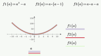

One word of caution: You should vectorize the function call whenever you use a vector as argument of a function which is written for scalar arguments. Its not necessary in case of your function, however, it is best to get into the habit of always vectorizing in such cases, as this saves you from having to check whether it is necessary in each specific case.
An example: The three functions f1, f2 and f3 seem to be identical, doing the very same
But when you provide a vector of values as function argument, you see differences
Reason is that in f2 and f3 the first multiplication is done with two vectors now and Prime of course has to use vector multiplication (dot product, scalar product) here.
So I got into the habit of applying always vectorization when I feed a vector into a scalar function, not having to think about if it would be really necessary or not:

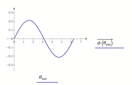

You may also consider using a range phi with a smaller step width to make for smoother plots and a vector phi with less values for the tables. And you don't have to define that range/vector right on top of the sheet as you had done, but rather right in front of its first use (plot, table, ...)
And of course you could also use vectors for plotting even though ranges are made for it and may feel more natural to be used in plots.
