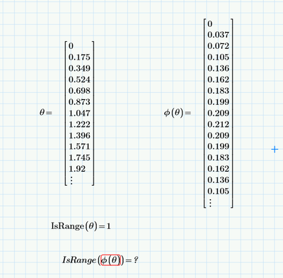

So a few days ago i made a post of my graphs not working.
Back then i asked 3 teachers to look at it but they all couldn't solve it. Luckly the ptc community could.
But now i need to present the solution and i want to add fancy things so it looks more complex then it is.
For example first check of something is a range but somehow my second value wont work for it.
Any other idea's to make it look more complicated?
(To:XV_10815251)
Prime alerts you that you are misusing a range, using it for something it is not intended for.
A range is not a collection of values like a vector (even though Prime unfortunately displays them the same way). A range rather is an instruction, kind of an implicit loop.

So using a range as a function argument is perfectly OK when creating a plot
and Prime even is willing to display the values calculated (which may be misleading...)
but what this function call actually creates is not a valid data structure recognized and accepted by Prime.
You experienced this when you tried to use "IsRange" and you get the very same error message if you simply try to assign it  to a variable
The right hand side simply is treated as an invalid data structure to Prime which it refuses to use - its not a scalar, not a vector and also not a range.
And IsRange(ϕ) sure must return 0 because its not a range but rather a function
So use ranges just for what they are intended for and vectors for the rest. And no, you are by no means the first person to stumble over this difference between ranges and vectors, and you certainly won't be the last. I guess it's happened to all of us at some point, and it's an age-old pitfall.

Dan zegt het 0, dit betekend volgens mij dat het geen range is. kan ik dan op een manier zien wat het wel is?
LucMeekes
(To:XV_10815251)
D'r zijn nog meer IsXxx functies: IsScalar, IsArray, IsString...
Er is geen WhatIs functie.

Thank you for sharing your knowledge; I can now give a proper explanation to my teacher.
