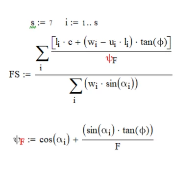

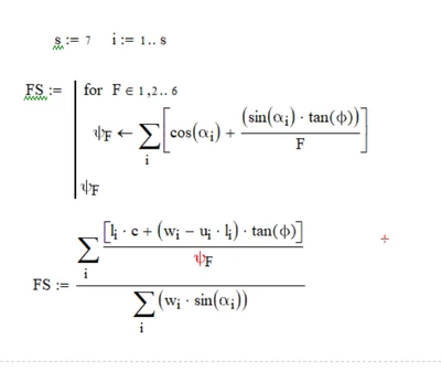

So I have a hw problem that doesn't need to be solved this way but I have a feeling I will be using the Modified bishops method on a future project so I wanna take my time on this. Basically, I have two equations :
This is a function to find the Factor of Safety for a slope under certain conditions. In the actual psi equation, the F is The same FS in the upper eq. This requires an iterative process where you guess a F run it through psi and then the FS function. You then compare F to the resulting FS to see how close they are. You continue guessing F until F and FS converge to a similar number. The summations with the variable I represent the 7 different vertical slices that are being summed to form the whole slope. I want to write a program where I can input F as a sequence like 1,2 .. n. It then should pick the first F and run it through psi summing over the 7 slices. This should output one character into the psi resultant vector. Overall once it has run through all F, I want the resultant psi to be an nx1 vector with each psi value pertaining to each F. Then I want it to run the FS equation, similar to the psi I want this to sum over the seven slices for each psi input. At the end, I should have a resulting FS vector with one FS value for each F value input. Here is what I have so far:
I am an absolute beginner with coding so any help would be greatly appreciated!

I don't have your version of Mathcad (I've only got Prime Express 7). However, I can make a few comments on the code you've shown.
You are expecting ψF to be a vector and use it as such in the 2nd expression for FS.  However, ψF doesn't exist as far as FS is concerned.  ψF is a local variable within the first FS expression and doesn't exist outside of it. So what you needed to have done was assign the result to variable ψF instead of FS - this ψF is a different object to the ψF defined within the first expression.
A second problem you've got is that the ψF in the 1st expression is *not* a vector.  All the expression is doing is assigning the summation result to ψF., overwriting any previous values.  Consequently, the first FS simply has the value of ψF for F = 6.  You need a second iterator to assign the results to a new element in ψF  (you could use F, but only if any future F you have in mind continues to pull its values from an integer range).
The third problem is that you need an iterator (range variable or for/while loop) in the second expression to select each value of ψF; otherwise, you're just dividing the (intended) vector ψF into the top summation expression.
Unfortunately, my version of Mathcad doesn't allow programming, but I can show a (crude) version of your code that uses functions.

Apart from your iteration proposal and the solve block proposed elsewhere you can also do:
If you equate this to FS, you get:
So eventually:
If you define:
You can solve that simply with the Mathcad's built-in root() function:
But of course only if the vectors l, u, w alpha, and the values phi and c are known.
P.S. Of course you could also define the function f as:
but this function has a higher risk of running into errors because FS is the denominator of a ratio that fails if FS becomes 0.
